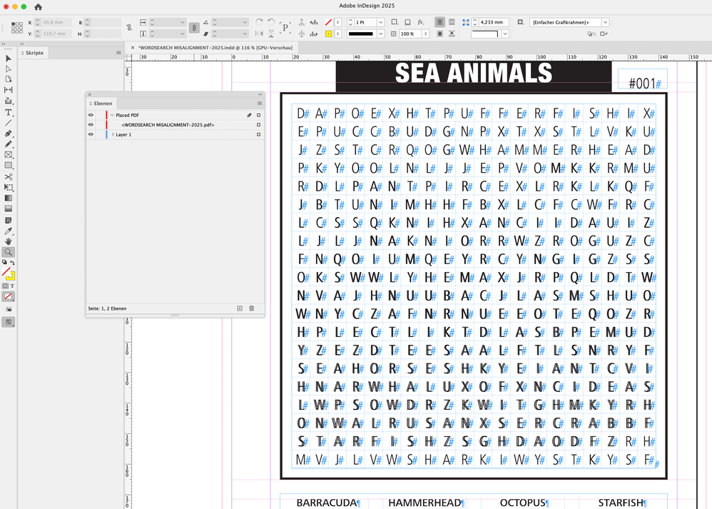

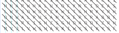

I am creating some word search puzzles using Tables. I have all the letters centered vertically and horizontally in the cells using styles. Everthing looks perfect in indesign but once exported to PDF the last 1-2 rows of every table are shifted to the left/right side. I used a monospaced font to make sure everything looks even but these last rows are not cooperating. Please see photo below:
Photo below this is the same as above but with strokes around the cells so it's easier to see. Top row everything is centered. As it moves down it moves more and more to the side. Again, this is only how it looks AFTER exporting. In Indesign every is aligned perfectly.

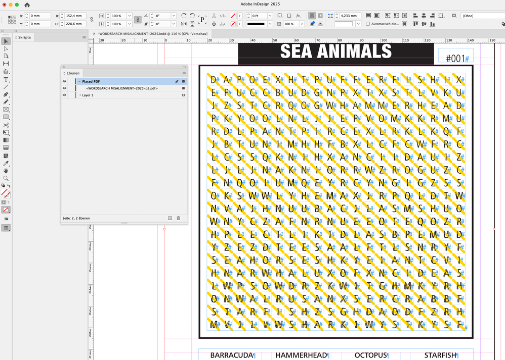

I tried adding diagonal strokes to the cells just to see what happens when exported and then everything was magically aligned... See pic below:
So... then I tried keeping the diagonals in the cells but setting the stoke weight to 0pt aaaand everything is misaligned again.
I found a super crappy way to make it export correctly is by outlining all of the text. But I have 100 of these puzzles created and once outlined I can no longer easily edit them. Obviously this is a bug and not a feature. There must be some way to make this work. I attached an indesign file with 1 puzzle if you need to look at it. Please help!

check my first post above for screenshots. I ran some tests in the meantime:
  • First, replacing the font in Illustrator, which worked fine, no more text shifting, even without converting to outlines.
  • Then, i just opened the original PDF (with the old font) in Illustrator and simply re-saved it (Save As). This also worked fine. So the problem isn't related to the font at all, but the way the original Illustrator PDF was created. This probably comes down to version differences, because our editor is still on CS6, if the metadata is to be believed.
I should have explored this problem more apparently, converting text to outlines was unnecessary. Just re-saving the PDF in a modern standard did the trick. Lesson learnt and sorry for wasting everyones time.

What it all comes down to is: this is a bug. It's not an expected result based on the file, so it's an anomaly that needs to be addressed, especially so since it's not a consistent result. You might want to add it to the inDesign bugs list

my solution was to check feature "Tagged" in the PDF Export dialog with a PDF/X-4 preset.

Substituted missing fonts in the table with Frutiger Next Pro Condensed.
Still the export to PDF misaligned the characters like that:
The trick to use diagonal lines in the cell did not work as far as I can see.
With diagonal lines I see a different misalignment than before:

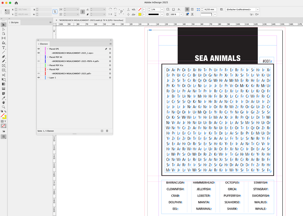

Exported with default presets PDF/X-1a and also PDF/X-4. Same results: shifting type.
InDesign 2025 v20.3 on macOS.

Now I tested EPS as export format. That worked:

Interesting, we got a slightly similar problem with our word search puzzles. In our case the letters shift ever so slightly up, until the last three colums, which restart at the normal height. Everything looks fine in InDesign, but when we export the pages for printing the shift happens.
Our puzzle editor supplies us with Illustrator PDFs, which we place in InDesign. Just like you found out, when we convert the text to outlines in Illustrator and resave the PDF, the text behaves correctly. This type of puzzle doesn't come up as often, so we put up with this procedure.

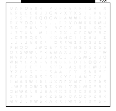

Looks like @BobLevine is right - I don't have your font installed - so it has been substituted:
Your table with white letters is on top of the exported PDF - covers almost prefectly - with just faint lines around.

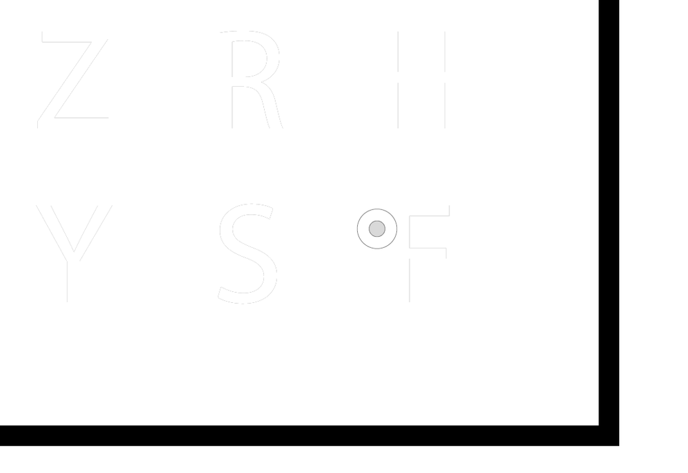

4000% zoom:
And here is a full page:

Interesting. I'm seeing the same issue. It seems like that each row is just a hairline shifted to the right cumulatively until the near the end where it snaps back to where it should be. I see nothng in the file that would do that.
I did however notice that doesn't happen if you use certain PDF export presets, e.g the "High Quality" PDF preset doesn't but the "Press Quality" does it, and there's really no difference between the two. I tried different levels of compatibility and compliance and it was all over the place.
Also, if I copy JUST the table into a new document, it behaves properly. I also created a brand new table in a new document with the same dimiensions and specs as yours and it works fine. Saving as IDML and reopening had no effect.
