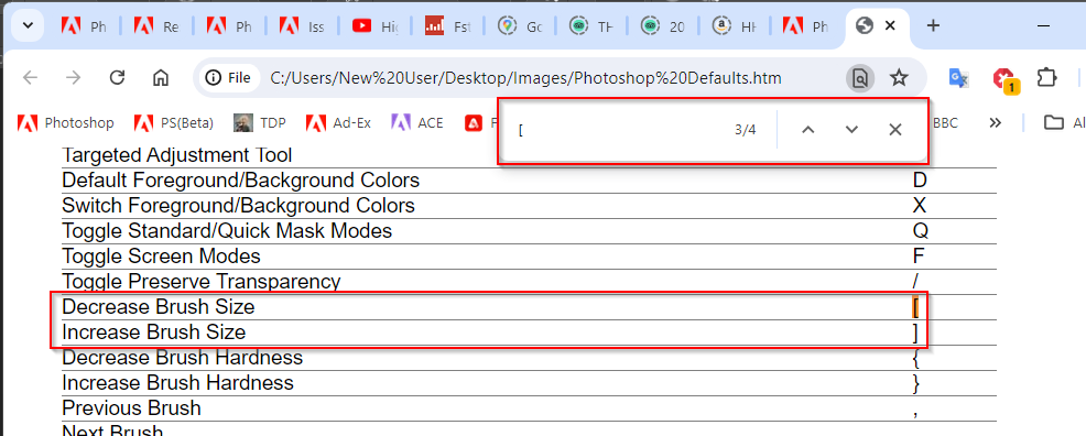

Jun 29, 2024 Jun 29, 2024
Guys, the latest version of Photoshop beta is  25.11 m.2679
I am using Windows 11 and the [ and ] shortcuts are working for me.
I have checked using the Essentials workspace, and reset that workspace (to make doubly sure).
Open the Keyboard Shortcuts panel (Shift Ctrl Alt K) and hit the Summerize button.
Make a note of where it saves the Photoshop Defaults.htm file and open it in a brouser.
Go to that Tab, and use Ctrl f to open the search dialog, and search for the [ character.  AFAIK those shortcuts are hardwired.  Least ways I don't know how to change them.  Anyone?
You can use Defkey.com to see other apps that use a specific shortcut, but it seems unlikely that you guys all have the same app trapping the [ shortcut.
This link lists 212 Windows apps that use [ as a shortcut.
https://defkey.com/what-means/%5B
