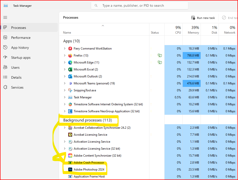

Opening Photoshop takes 4 mins running in Background prosseses before actually opening
  • July 23, 2024
  • 返信数 8.
  • 1891 ビュー
  • I have been running Photoshop CC fine for a year on this PC:
Processor 12th Gen Intel(R) Core(TM) i7-12700F 2.10 GHz
Installed RAM 32.0 GB (31.8 GB usable)
System type 64-bit operating system, x64-based processor
NVIDIA GeForce RTX 3060 Ti (Driver ver 560.70)
Edition Windows 11 Pro
Version 23H2
Installed on ‎6/‎07/‎2023
OS build 22631.3880
Experience Windows Feature Experience Pack 1000.22700.1020.0
  • A few weeks back I started getting intermitent issues with opening Photoshop. It does not open straight away but sits in Background processes for just under 4 minutes, then eventually will open.
  • Once Photoshop is open I am able to open files normally from within the app (File>Open) but if I try to open files from other apps into Photoshop (File Explorer>Open With>Photoshop 2024) it again sits in background processes for the same 4 minutes, then eventually will open the file in Photoshop.
  • I have tried updating graphics drivers and also performed a full uninstall/reinstall with the Adobe Creative Cloud Cleaner Tool.
  • Any ideas on a fix for this?

Dramenon
July 25, 2024
The other portion possibly could be as simple as Logging out of Creative Cloud and logging back in.
There were issues, some time back, related to a Photoshop process getting stuck after launch.
If that doesn't help then we probbaly need to see Photoshop Help > System Info in full.
/end of line/
glennm89105513
July 25, 2024
Ok I gave those two options a go and had no luck with either. Is there anything else that might fix this issue?
Dramenon
July 23, 2024
One idea... When I have encountered similar behavior I made a point to Quit Photoshop, then proceeded to shutdown all "Creative Cloud" processes in Task Manager/Activity Monitor.
Then launch Photoshop. If this works enjoy the day...
If that does not work then I might consider a less friendly option (sorry) deleting all the items in:
C:\Users\yourname\AppData\Roaming\Adobe
These are temporary items and preferences etc and will be generated again. You could back them up if it makes you comfortable.
After cleaning out files...
Launch Photoshop.
If this works enjoy the day... if not, we look at soemthing else.
