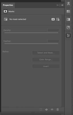

P: Adjusting layer properties doesn't work for Hue/Saturation/lum. HSL layers
Community Beginner ,
Apr 29, 2025 Apr 29, 2025
The tab to click on and change the properties for an adjustment layer randomly disappears. Quitting and re-opening the app solves the issue, but it will happen again within minutes, usually when switching between different projects or different app on the computer.
On Photoshop v26.6 - Mac Mini M4 pro, 32gb ram, 1tb ssd.
Any help would be appreciated!
Screenshot 2025-04-29 at 11.11.02 AM.pngScreenshot 2025-04-29 at 11.17.20 AM.pngss
Bug Acknowledged

Just got a new position, setting up new imac and photoshop and getting my workspace how i like it, and find the Hue/Saturation adjustment layer just...doesnt work. It has nothing to do with color values, just "Density" and "Feather". All other adjustment layers have their properties display correctly. I can use H/S as a destructive edit, but thats it.
I havent even gone into Preferences yet, so its not a "reset preferences" issue.
Sep 06, 2025 Sep 06, 2025
Can you show us a screen shot of your workspace with layers and properties panels?
So this is a new system, and Photoshop has been installed for the very first time?
Is this the release version of Photoshop?  Beta now has a new Color & Vibrance adjustment layer.
It sounds like you are able to select the Hue/Sat adjustment layer, but it is not showing what you expect in the Properties panel.
Anything you can tell or show us to clarify would help.
Just realised whaty is going on.
You have the mask selected

Mine does't even show the sliders, just the mask options (grayed out because the mask isn't selected)
Any tips appreciated 🙂
Sep 18, 2025 Sep 18, 2025
Please post a screenshot showing the Layers panel alongside the Properties panel.

Same issue here: the properties panel only displays the masks option, can't select hue/saturation. It's only the hue/saturation adjustment layer, all the other adjustment layers work normally. Restarting Photoshop fixes the issue for a while.
This is on Windows 11 in Photoshop 26.11.0.

Just had this issue now. Using Photoshop 2025 (updated to version 26.11.0 a few days ago) on a Macbook Pro. Hue-adjustment layer not working/displaying properly (showing density/feather?). Even when I don't use an adjustment layer and just use hue/saturation still displays this way. I restarted several times, still not working. Is there a workaround? I  have a deadline today.

Oct 22, 2025 Oct 22, 2025
@Anshul_Saini @Sameer K
I have found a way to 100% reproduce it, at least on my machine it is.
Photoshop 26.11
macOS Tahoe 26.0.1 on Mac Studio M4 Max
  1. Open any image
  2. Create a blank layer
  3. Create a Hue/Sat adjustment layer
  4. ⌘⌥+G to clip that Hue/Sat to the blank layer
  5. Group the two newly created layers (see attached image)
  6. ⌘+E to merge the group into a layer
  7. Create another Hue/Sat adjustment layer
  8. There you go. No layer properties.
9. Move it down and the properties panel becomes available again. (as @antonioi21376345 mentioned). Move it back up and you lose it again.
So something goes wrong when you flatten a group that contains a clipping hue/sat adj layer?
I hope this is the trigger you are looking for.
I first replied to this thread on May 6th. It's been too long.
We need this fixed.
I am from China, so I probably won't be able to join your debug session. Good luck.
Guys, if you can reproduce this too, please help the adobe team.
Adobe Employee ,
Oct 23, 2025 Oct 23, 2025
@LEMONardo —Awesome! Thank you so much for your effort. I've recreated this on Windows. I'll share the steps and the video replay with the team to verify.
