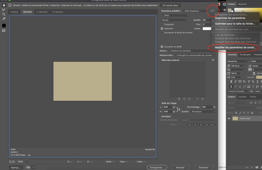

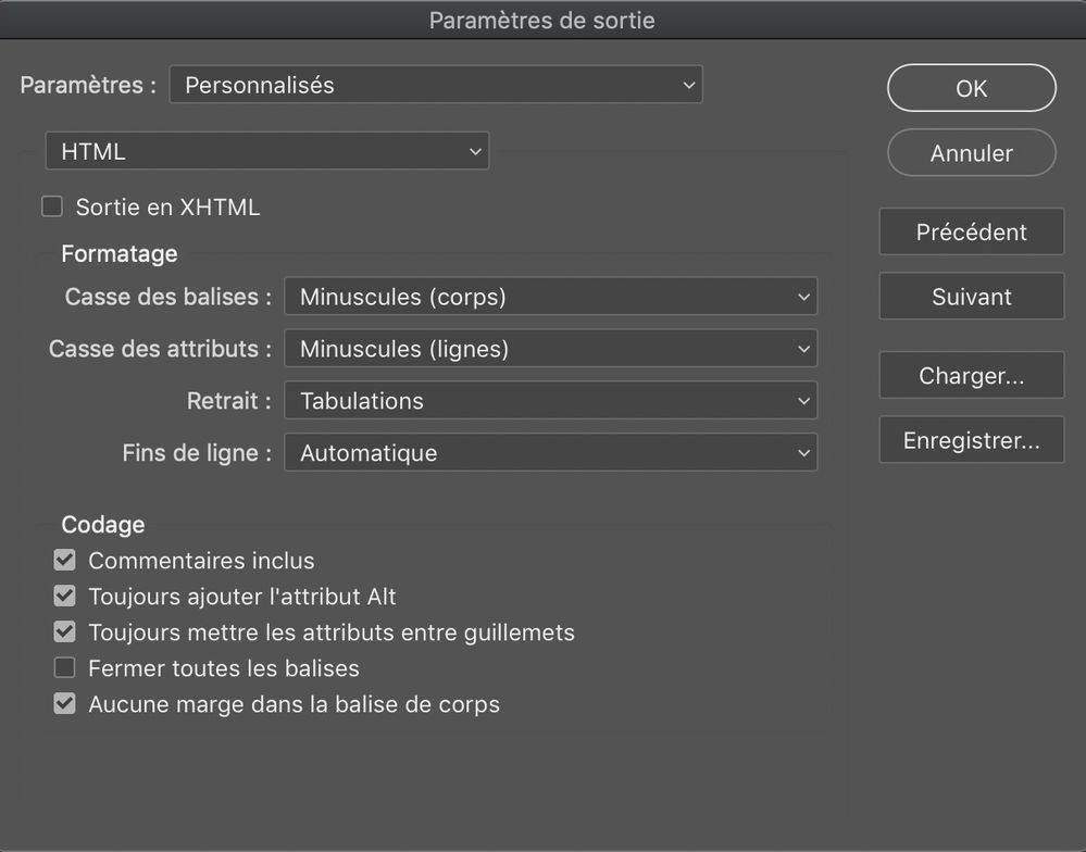

I have this as output parameters (sorry it's in French)
Can you please compare with yours?

To find the settings I showed you, when you save for the web look top right :
They are the "Output parameters" maybe I messed somethig here? Once you have the window in front of you you can switch tab with "next" and "previous". Let me know if you have something similar.

Ahh @YESTom I see these output settings now. I even did some googling and in app search to try and locate but I can see what you shared in your screengrabs. I've posted the English screens as well below but as a first pass, most of what I'm seeing looks to be the same and I've not changed any of these from default ever. The ONE thing I do see that is different in your setting is on "Filename Compatibility" Mine has Unix checked and you don't have anything checked. Maybe check the Unix box and see if that fixes it and let us know!
Screen Shot 2021-09-20 at 11.16.05 AM.pngScreen Shot 2021-09-20 at 11.16.12 AM.png

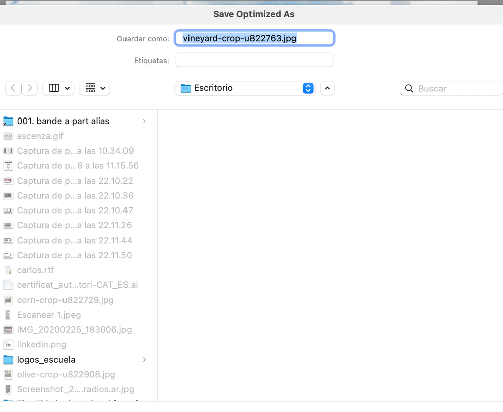

Hi, I want to fix this little issue that always have when I want to "Save optimized as" or simple "Save".
The name and the extension appear highlighted together and if I type a new name the extension disappears.
I remember older versions did not do it automatically.
Mac user.

hey @Bàp Film School unfortunately its not going to back to to  the way it use to be. This started with Apple making a change and you'll see across the board on every application running on a Mac, not just Adobe apps, that the whole file name area will always be highlighted BUT the majority of apps just don't show the extension on that line. For example when you go to save a TextEdit file it doesn't show you .txt on a Save screen.
Not it was really a problem back when you would create the name for your file without an extension and it would save a file that wasn't openable until you add the extension to the file but fortunately this has been fixed.
SO while it takes a little getting use to, with the newest versions of PS we can just ignore that it shows the extension and type away what we want the file name to be and when its saved the extension will automatically be added. If there is something that might be changed with Photoshop in the furture then maybe its to give us users the option to hide the extension from being shown in the Save As: field in the first place. I've gotten in the habit of looking at the Format: toggle anyways to confirm I'm saving out as the format that I want it to be anyways.
Hope that helps!
