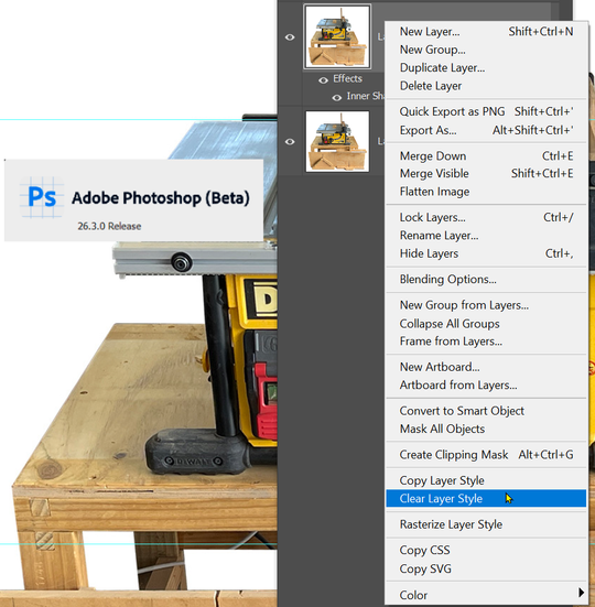

Clear Layer Style appears to be missing in Photoshop 2025 (ps versions 26.1 and 26.2 and the latest Beta 26.3)
on both Mac and Windows.
If one right clicks on the Layer to the right of the Layer thumbnail or layer mask, the Clear Layer Style is missing, however if one right clicks on the small fx or in the area where the Effects are, the Clear Layer Style is there.

Hmmm... just noticed that these are both beta 26.3.  I had a problem opening the release version, and had to clear a process with Windows Task Manager. Ctrl J was not working ether.  I think I need to restart my computer and try again
Dec 23, 2024 Dec 23, 2024
It seems if a user has Show Simplified Right Click And Flyout Menus enabled, then Clear Layer Style shows
Same thing here Jeff.  (My release version opened and worked OK after a restart)

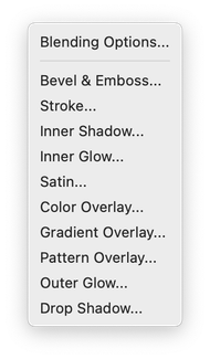

By @Thiagomga
That's because blend if settings are (*generally) not an explicit layer style/fx.
Blend if is grouped under Blending Options, which is part of the Layer style window, however, it's not technically a style (notice the separator line in the contextual menu below):
https://community.adobe.com/t5/photoshop-ecosystem-ideas/request-an-eyeball-icon-in-layers-panel-for...

@robertw44482386
That's why I had the asterisk * and a link to such an example where copy/paste layer style was used for blend if. I realised that I was contradicting myself! :]
These elements may be part of the underlying properties of layer styles, but ther are not a "named style" preset such as "Drop Shadow";
You go on to mention blending modes, opacity etc. It makes no sense to clear a layer style if there is only opacity applied.
A layer style is one of the named "fx" in the screenshot, below the divider.
