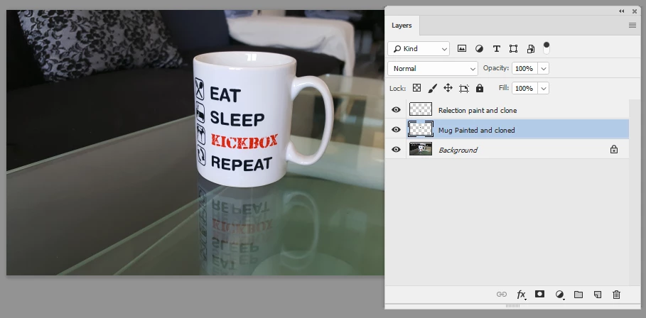

So, first the background story. I made a logo vector and send it to a company who makes custom print coffee mugs. This company sended me the coffee mugs and now I have to take product photo's. I tried without sunlight and using artificial light, but it was horrible. The coffee mug wasn't even white and the red looked orange and overall it was just bad.
Today however, I tried sunlight and the quality is amazing and it looks so bright. One problem is that there is sunlight line on the coffee mug pictures and my question is thus:
How can I Photoshop these sunlight stripes away the BEST WAY?
There must be a best way, because I can't imagine I'm the only one with this problem.
Hi
Make a selection of the letters then use the brush tool to paint - picking up colour (Alt-Click with brush) from the good parts. Then invert the selection and paint onto the white parts of the mug. Repeat for the reflections.
The best way to avoid this is through careful lighting and watching reflections at the time of taking the image. It can save you a lot of time later in Photoshop ![]()
Dave

Hi
Dave
I also wanted to do this, but thought let me ask the community. Maybe they know something better. I actually used to just do brush tool and picking up colour from the good parts and then just brush, but you select the letters? What do you mean? You magnetic tool them or something? Could you explain this part more, because it seems very handy to select them and not worry about brushing outside the letters.
I just used the quick selection tool to select the letters and painted in the selection - inverting the selection when I wanted to paint around the letters
