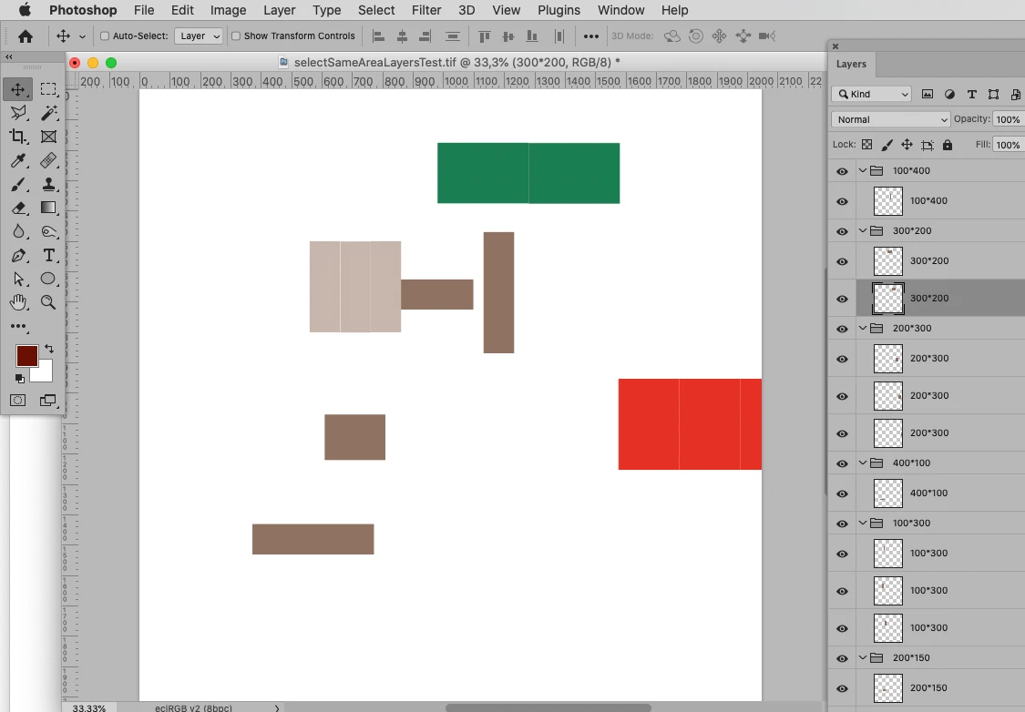

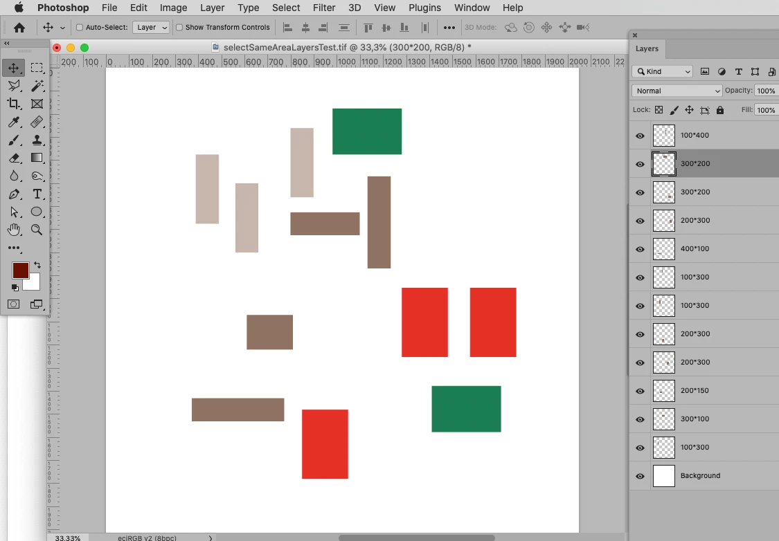

Hi every body how i need to know how to select all photoshop layers by size or diminsion ( CM or inch ) Please
このトピックへの返信は締め切られました。
解決に役立った回答 c.pfaffenbichler
- It is not necessary to carry out the required if this is difficult
- Is there a problem with collecting all the layers of the same size and putting them in a group
I want to get to the nearest solution to the problem
How familiar are you with JavaScript and Photoshop Scripting?
Are you capable of adapting a Script that contains the necessary basic operations to your needs?
The below Script should group Layers that have the same bounds dimensions and align them horizontally in the group (see screenshots).

返信数 3
JJMack
November 24, 2021
Why did you accept that script as a solution for you problem?  It does group same size layers like you want.  It does not distribute the layers optimality over the canvas, You can move the groups over the canvas  if the grouped layers will fit within the canvas width, and if when you distribute the groups layer they fit within the document height.  If all the layer are then over the canvas I would not think the tiling would be optimal.   That is the hard part of your problem. Here I have a document like the one you posted as far as the image layers distribution goes.  I ran the script. The layer were grouped and moved many layers off canvas and many over lapping other.  I then move the  layer groups  on canvas and distributed them so the was no overlapping layers.  I would not call that layout optimal.
JJMack
c.pfaffenbichler
November 24, 2021
One could process the groups further, but getting at a truly efficient usage of canvas space would seem quite difficult to me.

Mohamed Hameed21513110
November 24, 2021
Really, thank you c.pfaffenbichler
The first code works very well for me
But I ask you for a code that checks all groups
And it converts it from px to cm
Really nice and amazing work
Thank you again
c.pfaffenbichler
November 23, 2021
If the areas are rectangular this might help:
// 2021, use it at your own risk;
if (app.documents.length > 0) {
    var theLayers = collectLayersBounds ();
    var theBounds = activeDocument.activeLayer.bounds;
    var thisArea = (theBounds[2] - theBounds[0]) * (theBounds[3] - theBounds[1]);
    for (var m = 0; m < theLayers.length; m++) {
        if (theLayers[m][4] == thisArea) {selectLayerByID(theLayers[m][2], true)}
November 23, 2021
Thanks
But this is not what I want
I have attached an explanation of what I want
I want when selecting an element all the elements are selected based on the dimensions knowing that the layers have no name..
Layers may have different names, but they are defined by dimensions
c.pfaffenbichler
November 23, 2021
Trying to explain what you mean at this point seems fairly late.
Have you actually tested the Script?
The Layers are not selected based on the Layer Names but based on the Layer Bounds (edit: actually by the bounds width multiplied by the bounds height).
c.pfaffenbichler
November 23, 2021
Please elaborate.
Screenshots might help clarify.
November 23, 2021
I have File with multi layers with different Size layer ...
I need when select layer in photo 001 and run script  collect all layer with same size in photo 002
c.pfaffenbichler
November 23, 2021
Sorry, I am not sure I understand.
There are two files involved?
If so how can the second image be identified?
Will there only ever be two images open at the same time when the Script is invoked?
