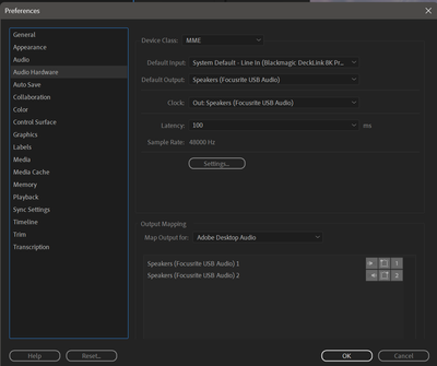

Community Beginner ,
Nov 15, 2023 Nov 15, 2023

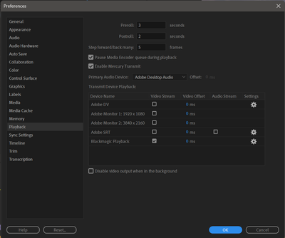

Following a recommendation from a Blackmagic engineer, we'd changed the Decklink output setting (found in Preferences>Playback and then by clicking the settings wheel next to the Blackmagic card) to SCALE DOWN. It was on Scale up.
So far, Premiere 24.0.3 has been running fine for about the last 25 mins, which is the longest it's run without problems since the issues began.
I think it would be good if people could try this and report back as to whether it fixes it or not.

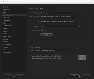

@Bruce Bullis Today I was editing for about 20 minutes today and I triggered the bug. The way in which it triggered was via playing through a timeline at high speed. I used the keyboard to do my playback speed change (tapping L).
I also changed my audio hardware output to be my BMD decklink 8k.
