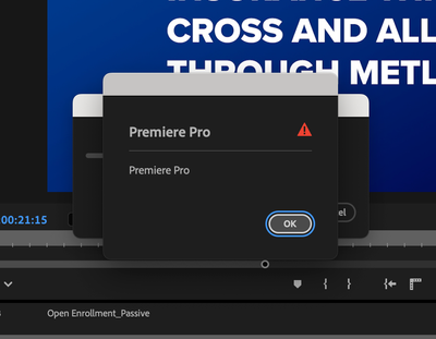

Hello all,
I'm writing to see if anyone has any ideas for this bug I'm getting when trying to export. See screenshots below. It's an empty window. I'm on the latest version of Premiere. The error also occurrs on my Sonoma Mac, and a Mac running 15.01.

Thank you Rach! I will keep this in mind. I actually narrowed down the issue: the error occurs when using Loudness Normalization in the export settings. Very odd. Turning it off allows the export to proceed as expected.
Community Beginner ,
Nov 05, 2024 Nov 05, 2024
Going deeper into the troubleshooting, I discovered the sequence was created with one of the new broadcast sequence presets, so the channel configuration was all screwed up. This leads Loudness Normalization to fail - and I wish the error message would have described that.

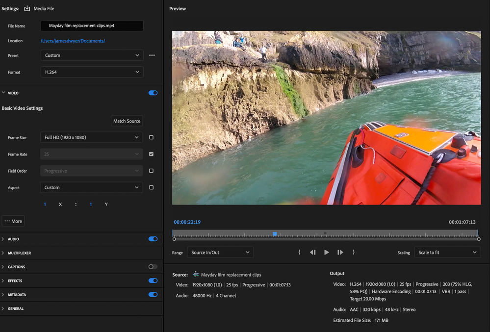

  • Issue - Premiere Pro will not export from the "Export" tab. I click on the tab, select all the options and then click export and receive an error message with no details (see attached). When I send to media encoder, the export fails there too. All I am exporting are two short clips and a colour matte in a single sequence. Previous versions of Premiere allowed me to export no with problem.
  • Adobe Premiere Pro version number: 25.1
  • Operating system - MacOS
  • System Info: CPU, GPU, RAM, HD:
    • Apple M1 Pro
  • Video format: Provide information about the type of video you're using. For example, XAVC-I 4:2:2 10-bit. If you're unsure, let us know what settings you selected on the camera. Sharing a sample file is useful if you don't have access to the camera
  • Workflow details: Multiple clips from different source
  • Steps to reproduce:
    1. Put two clips in a sequence
  • 2. Clicked export
  • 3. Error message appeared with no details
  • Expected result - Video exports as normal
  • Actual result -  Premiere Pro shows an error message with no details

Please post screenshot export settings (entire UI)
Does the red exclamation mark  not tell you anything in the Events Panel?

New Here ,
Jan 13, 2025 Jan 13, 2025
Thanks for your reply. Loudness normalisation is in use but that doesn't affect a separate sequence that exports fine. No events recorded for the export in the events tab.

Hi @jamesd51323803 - If you uncheck loudness normalization do you still get the error?
New Here ,
The export works when you disable loudness normalisation. Not a big issue for this export, but is that a known bug?
Adobe Employee ,
Hi @jamesd51323803 - I'm going to merge this thread with the Primary.  Yes we are aware of this bug and are working on a fix.  This is caused by a mismatch between the number of audio channels in the sequence (the broadcast presets have 4+) and the audio channels in the export, which is getting mixed down to stereo.

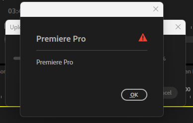

New Here ,
Feb 20, 2025 Feb 20, 2025
I've been using premier pro for years, since i updated it I cant export anymore. As soon as i click export i get the attached message immeditily. It doesnt even try to export it, just gives me the error message. Been searching for a fix but getting no results. There is no info on the error message, just this blank !  I need to get this fixed and premier hasnt released a new update to fix it in ages! Anyone else had this issue?
Im using a mac Studio M1 Max so my machine should have fly through this.
What does the red exclamation mark in the Events Panel tell you?
Uninstall, use cleaner tool, re-install. See how that goes.
Also trash preferences and media cache.

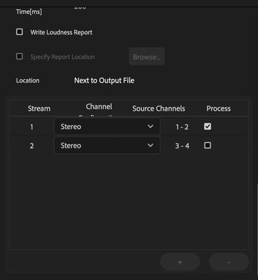

I fixed this error - of course without help from Adobe as usual -
the trick is to add another 2 channels under effects (scroll down from audio normalisation) hit the PLUS sign, I added two more stereo channels. I didn't even tick 'process'.
Resulting file has 2 audio channels (as selected under main audio tab) presumably normalised.
