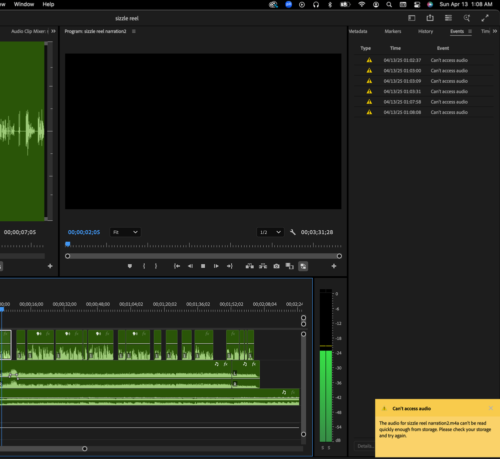

Community Beginner ,
Apr 12, 2025 Apr 12, 2025
Ugh, I also am getting this issue. I just edited all the VO for a sizzle reel, putting them in time to music - and then Premiere suddenly stopped being able to read the VO audio. Do I really have to start over?
