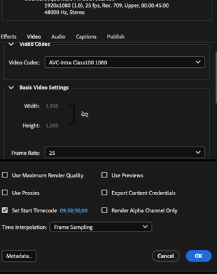

When exporting a sequence from PP to AME - when setting 'Set Start Timecode' this only accepts Drop Frame timecode and not 25 PAL.
I've set it to 09:59:55:00 within the preset - however when importing the clip back in the clip has a start timecode of 09:59:54:23
Sequence is 50i and the Preset is AVC Intra 100 25 Upper Field First

After exporting and re-importing the clip starts at 09:59:49:23 not 09:59:50:00 and active visuals start at 09:59:59:23 and not 10:00:00:00 as within the original sequence.
The duration and framerate of the export appears to be correct - just the timecode has been shifted
If I export directly from Premiere and do not use AME the timecode works as expected - visuals start at 09:59:50:00 and active visuals start at 10:00:00:00

Yeah same settings in ME. ME Set Timecode is always ; rather than : for timecode so it looks like it's just set that way as default rather than changing based on source timecode it should be reading.
