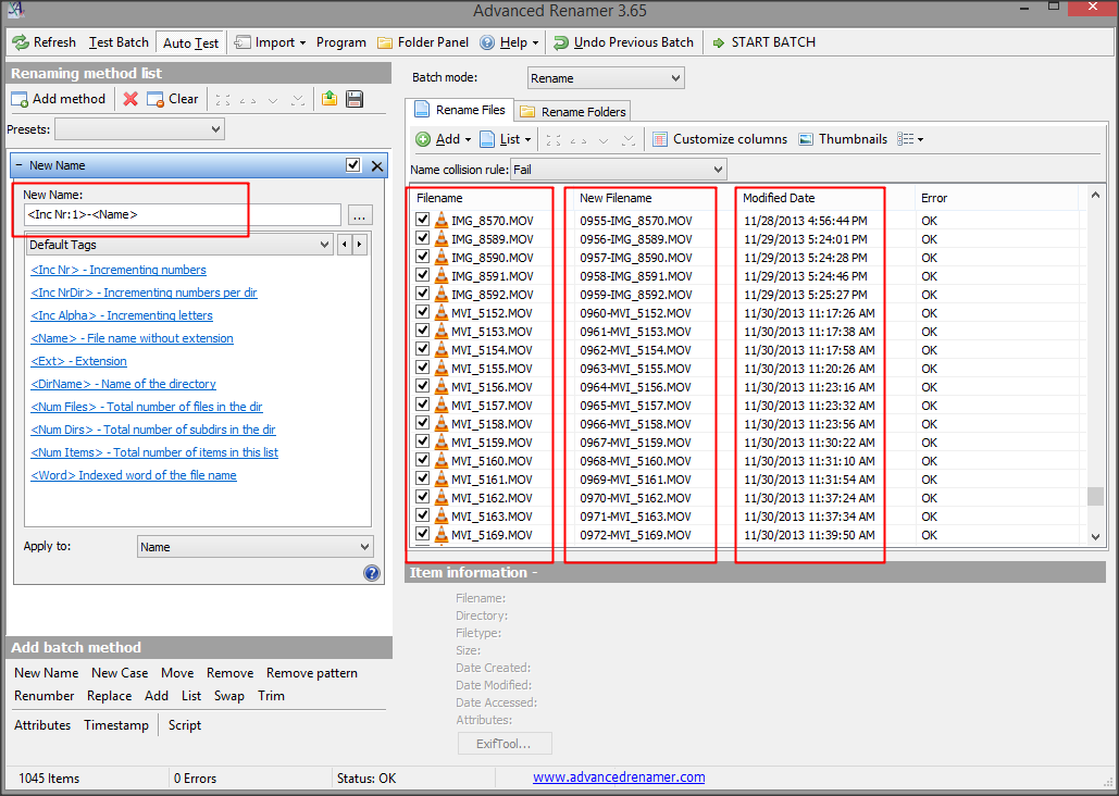

I'm certain this has been mentioned already but one workaround is to use a file renaming tool such as the free Advanced Renamer (which I just downloaded/installed/tested) to sort the files by modified date and then append incremental numbers to them based on this modified date. I had a folder with over 1,000 clips from various cameras and this worked flawlessly. The whole process took about 2 minutes. See screenshot below.
Adobe: Please make this a future function.
