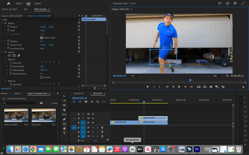

Community Beginner ,
Sep 01, 2023 Sep 01, 2023

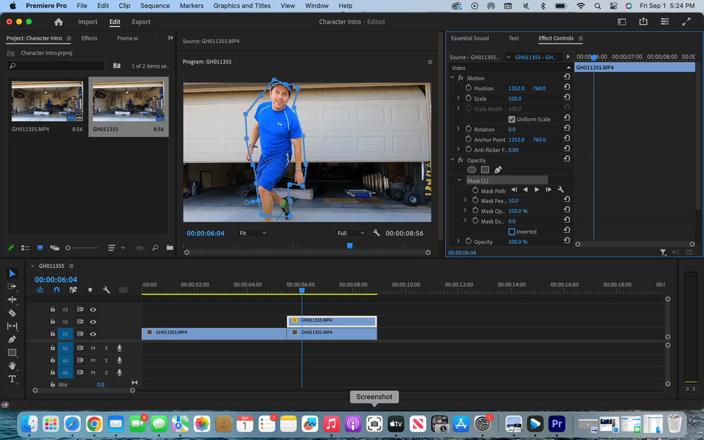

This picture is with the Invert option, still nothing
It looks like the same clip track 1 and track 2. Delete the clip on 1 or just move it (drag it) to the right, you'd have a black cut-out.

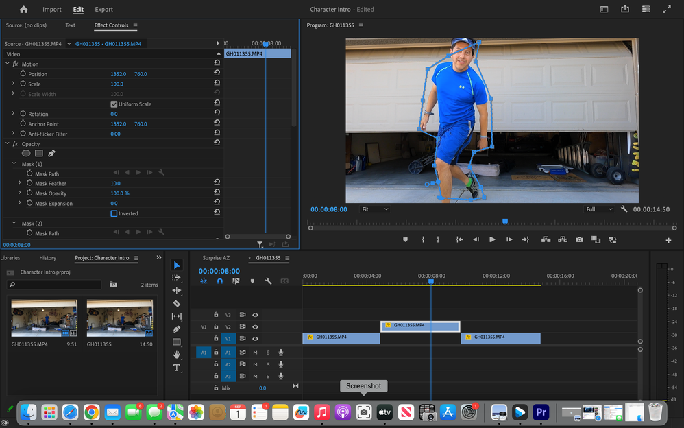

Make sure you've properly closed the mask. Just make a simple one with 4 points, and the last point is on top of the first point.

@Raul32027113d0wk,
Thanks for being so responsive. It all looks right, but something isn't!
For a fresh test, I would drag the clip from the Project Panel to Track 2 after the previous clips. In Opacity, click on the rectangle instead of using the pen - this will put a full rectangular mask in the middle of the screen. You should see the rectangle with the video showing, and black all around.
You can also right click in the Project Panel, New Item, and pick bars and tones. This gives you a test clip that should work.
If that doesn't work, I would restart PR, reset preferences, and create a new test project and test there.

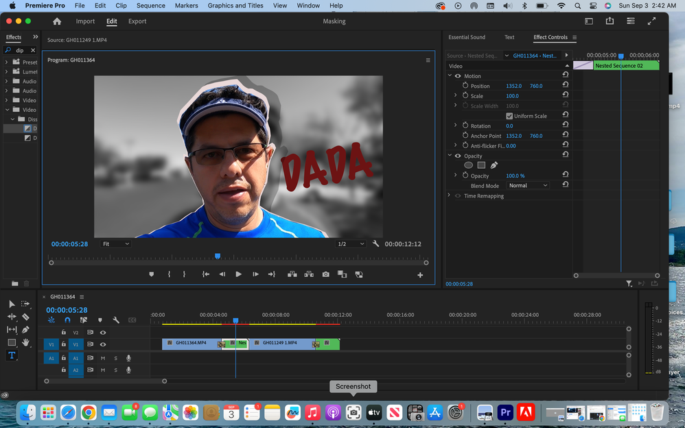

Sep 03, 2023 Sep 03, 2023
Congratulations on your persistence - and to Ann and MeyerPJ!
Stan
