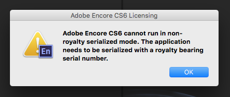

I use Encore (through CC) a few times a year when someone requests a DVD. I launch it the other day and I get this error:
Adobe Encore CS6 cannot run in non-royalty serialized mode. The application needs to be serialized with a royalty bearing serial number
I've tried unintstalling/reinstalling.
I've tried deactivating Premiere Pro CS6, and activating again.
I've tried logging out of CC and back in.
I've tried uninstalling all apps, and CC, using the cleaner tool. and installing again and I still get the same error...
Please, is there any solution to this?
18.6K

Aug 29, 2018 Aug 29, 2018
I responded to your other post, but this one contains more info, so I'll repost here with additional information.
I said, "Try running PR CS6 once, before you open EN." but it appears you have done that - and more - not sure what is wrong.
See this link:
Features and sequence presets missing | Premiere Pro CS6 and later
I can't tell if it is fully updated for CC type credentials, but it appears to be.
New Here ,
Thanks for the suggestion Stan.
I tried it just now. Still no go. But interestingly enough, a week ago I had an issue importing video to Premiere Pro CC from an iphone X, saying I needed activation to use codecs for HEVC, or something to that effect. Not entirely clear.
Maybe this is an extension of that now to encore...

Aug 31, 2018 Aug 31, 2018
I do know that "regular" CS6 (and earlier) with serial numbers require a special step to install, but since I'm on Windows I have NO idea what happens when you try installing through a subscription
For the serial number version...
CS6 and earlier programs have not been tested and will not be updated for Mac El Capitan or later operating systems
-which means that you try to use CS6 and earlier at YOUR risk of having problems due to Apple updates
-Apple did not maintain backward compatibility with old programs in El Capitan or Sierra
--Adobe has a workaround to Apple's problem of not maintaining backward compatibility
--READ HERE https://forums.adobe.com/thread/2301916 for an Adobe solution to installing old programs, including a link to installing the old Java runtime that is required
--Also read for more information https://forums.adobe.com/thread/2458382
Adobe Employee ,
I think the workaround listed in Installing Creative Suite on macOS 10.12 (Sierra) is only necessary if installing with the Creative Suite installers, John.  If they are installing through the Adobe Creative Cloud desktop application, then the installation at least should proceed normally.  You are right though it is becoming more difficult to install and utilize Creative Suite applications on modern versions of macOS and Windows.
Atempaj, you may be on the right track with installing Encore CS6 on a Windows laptop.  Since you have a Creative Cloud membership, you are not confined to installing only on macOS.  Even a moderately powered Windows laptop should be able to run Encore CS6.
New Here ,
thanks, I'll try that. Windows machine still kicks back the same error as on the Mac. I'm starting to think this is on adobe's side, Maybe my account is bugged? Is there anyway to verify that? All other apps like Premiere Pro CS6 install and open just fine. Encore seems like it installs just fine, but does not see my CC subscription.
Adobe Employee ,
Atempaj, what other Adobe applications and versions are installed on the Windows laptop?  If you are able to open other Creative Suite 6 applications then Encore should open.  Do you have any third-party plug-ins, for Creative Suite 6 apps, installed on both the Mac and the Windows computer?
New Here ,
No third party plug-ins on windows computer. No other Adobe apps on it other than creative cloud and premiere pro cs6...
Adobe Employee ,
Atempaj, if the newly created administrator account did not solve the error I was going to recommend the following steps:
  1. Run all available uninstallers for Adobe applications - Uninstall or remove Creative Cloud apps
  2. Download and run a fresh copy of the CC Cleaner Tool - Use the Creative Cloud Cleaner Tool to solve installation problems
  3. Download and install the Adobe Creative Cloud desktop application - Download Creative Cloud desktop app
  4. Download and install Premiere Pro CS6 - How to download and install Adobe Encore CS6
You can use these steps for both Mac or Windows operating systems.  When implementing these actions on the Mac, I would recommend using the newly created local administrator account.
atempaj  wrote
... Encore seems like it installs just fine, but does not see my CC subscription.
I'm a little confused. Is Encore installed and throwing errors when you try to open? Or not installing, which is what I thought the error messages are.
Here is a post from Ann Bens​ indicating her recent successful Mac installation of EN.
Re: Probleme installation adobe premiere pro CS6 mac 10.13.6
New Here ,
It doesn't matter which computer I'm on. It seems to be that it installs everything. Just when I launch it it give me the error thinking I don't have a CC subscription or serial. Premiere Pro was giving me the same issue thinking I was on trial mode when I tried to import iPhone x HEVC video files. The same error that I posted in the original post.
This is the licensing error I get when I try and launch it, not during installation.
I recently installed Premiere Pro CS6 (with encore) on windows 10 laptop (brand new). No other software on it other than Adobe CC.
Got the same error when launching Encore
