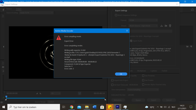

Hi
I have problems exporting my video in H.264 in premiere pro. I get the notification 'selector 9 error code 3'.
I have a Asus Vivobook 14 with an i5 processor. Before the summer, I had never problems exporting video's to that format. Now I am not able to export it in H.264
My adobe and premiere pro are updated to the latest version. So this will not be the issue.
How do I solve this problem?
Thank you in advance!

Have the same problem since the new update. You can try selecting Software Encoding instead of Hardware Encoding for this project. It will take a little longer but you can probably export it that way until we find solution for this problem.

See if you can export using Software Encoding. It's in the Video Tab of the Export Settings dialog box.

As it turns out, I was able to switch to software coding in the Edit>Preferences>Media tab.  When I did that, I was able to export the file.  That change requires a restart of the software.
Community Beginner ,
Nov 09, 2021 Nov 09, 2021
As an addendum to that message, I found that when I disabled Hardware encoding, through edit>preferences>media it made the editing process impossibly slow.  So I couldn't move around in the clips easily.  My solution was to enable hardward encoding, restart the program, continue my edit, but then, before attempting to export the project, to go back to edit>preferences>media and disable hardware encoding.  This requires a restart of the program, but ok.  It works. I can then export an MP4 file.
