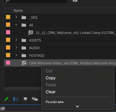

It's 100% a bug and its a real issue - wastes a lot of time. Check this out:
(All with my menu hiding @shezad5FAD  - the 2 examples are at almost the exact height position in the screen/ platform)
Contextual menu on a bin/ folder - it's fine:
Contextual menu on a file:
