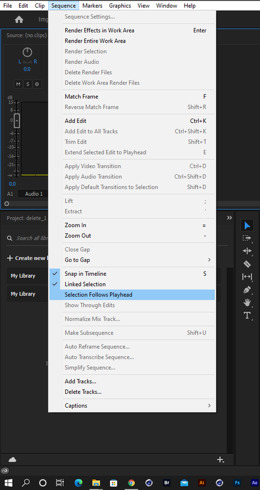

Turn off  "Selection follows playhead":

Wait, I appologize - it did solve the issue. The first time I tried that setting following your suggestion, i reloaded a project and it doesn't save when the software is closed.
Is there a way to save this setting between sessions? Because I saved my custom workspace and it didn't save the setting either.
