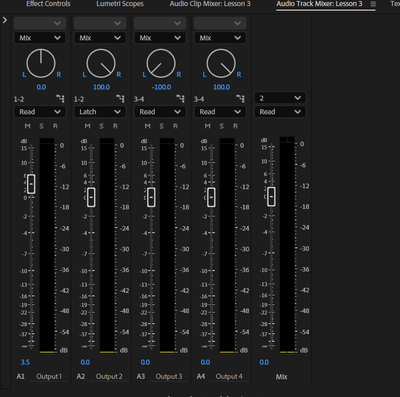

I had kind of a similar problem using Abobe Premiere Pro 2025. The thing is I can see both channels in the timeline. but only one shows on the spectrum/visualizer. I tried many things said in this thread and the given link also tried checking the channels which are 4. while I only need 2. I am working with a multi camera footage but using one audio. I tried left to right and even the other way around. Nothing worked then I went to the Clip Mixer. It didnt help but when I went to the Audio Track Mixer and saw that the Output 1 was on -100 which means eft turned it to 0 and viola. It was back. I hope it can help some of you if not all.
