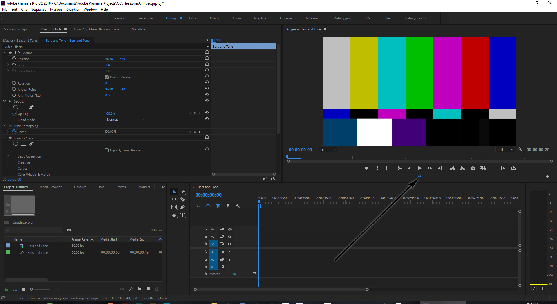

Thanks so much. It was an easy solution. Its the "FX" button on the Program Monitor. I must have accidently clicked on it. FX.jpg
Best,
Brit

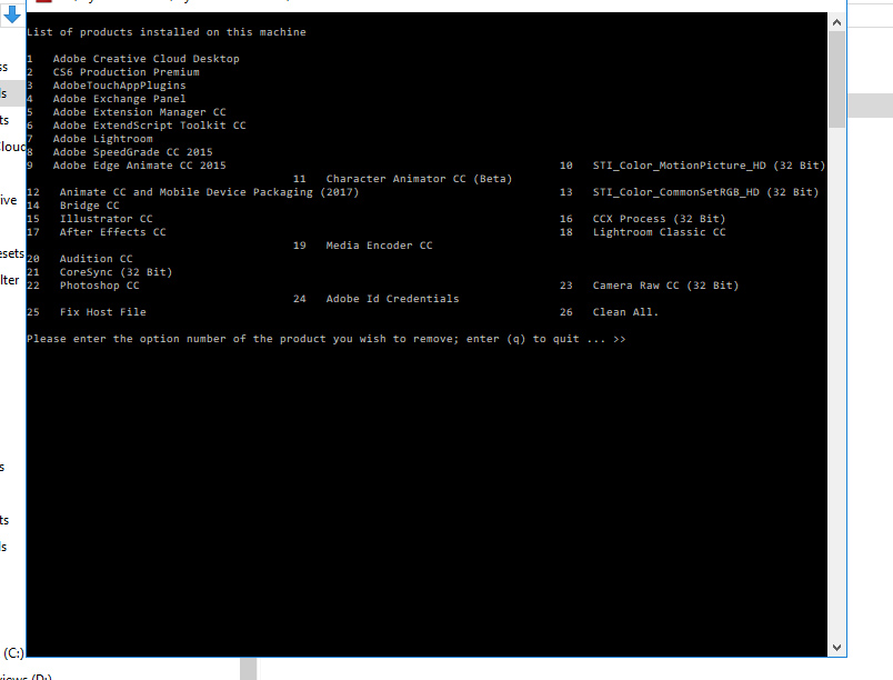

I uninstalled the program as per instructions https://helpx.adobe.com/creative-cloud/kb/cc-cleaner-tool-installation-problems.htmluninstall remover1.jpg it says;  “From the menu in the upper-right corner of the script window, select the version of the application you want to remove. Press Return.” I selected 3, and the next try, I selected 1: “all”, then I received a screen that asked for the name of the product. Premiere was not on the list (probably since it had been uninstalled as the instructions state to do first?)  I attached screen save images of the process.

That's why I said do not follow the instructions to uninstall before running the Cleaner. Happens 60% of the time for me.
Best,
Brit

YES! OMG I love how the bros all want to reprogram the source code when I knew it was something like this. Just had to go to the + button, add the fx button and toggle it off. Thank you!!!
