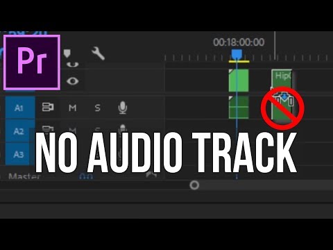

I'm having this issue as well.
I'm using a video-only nested sequence as an asset across multiple projects. When I go to drag the nested sequence from the bin into a timeline, it comes with a blank audio track that I then have to delete. Most times I have to place the nest at the end of the timeline instead of where I want it because I have to delete that audio track before it overrides any audio that I DO want. Very annoying.
There's no way in Premiere that I can find to delete all audio tracks from a sequence. At least a nested sequence anyway.
Participant ,
Apr 19, 2022 Apr 19, 2022
Ok actually just figured it out with the help of this video: https://www.youtube.com/watch?v=ckvU3zlpSfA
Simply right-click the nested sequence in the bin, select Modify > Audio Channels... > and uncheck all the audio channel boxes. Now it will come into the sequence as video only.
