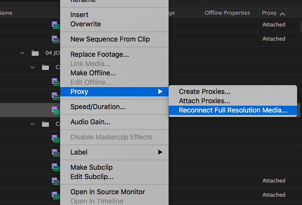

Great suggestion to add "video usage" to the metadata display. I found a ton of offline clips by comparing that column to "Offline Properties" and "Proxy" columns. I deleted them all offline clips or reconnected them, but only way I was able to reconnect them is by replacing with Proxy - Reconnect with higher resolution clips. "Relink" was not option. I've had a ton of clips mysteriously go offline when the program crashes and only way to relink them is via Proxy. So I have a ton of Proxy files. Could this be related to the offline issue I'm having?
