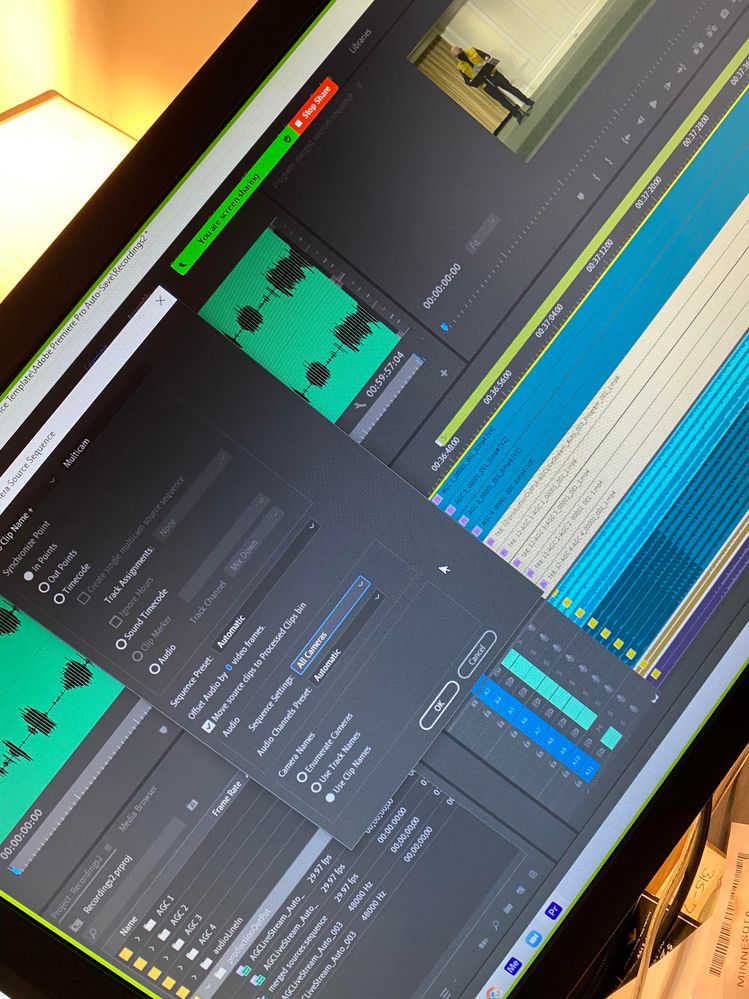

Hi Neil.  Wondering if you had any other thoughts.  I was looking at the production OutPut for the MultiCam Settings to see if maybe something is off here.  As you can see Each camera also records Audio on their respective devices but it is not quality that is why we use the Orange Line that is the Main Line in from the Mixing Board.  The videos are all linked to this audio and still when I create a subsequence I can't get the audio to follow.
Thank you!

Hi agcmcc,
I'm having a hard time understanding what you're trying to do, and where it fails. Those angled photos don't tell us much about your settings.
Can you please make a screen recording where you show us the steps?
Please include the sequence settings of your edit sequence too.
