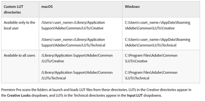

If you need the LUTs in any second location, you are dong it WRONG. And it can bite.
If you put LUTs in the following folder locations, and note these are not in the Program/Package folder trees! ... then Premiere, AfterEffects, MediaEncoder, and Prelude can all see them in the one folder setup.
This is the ONLY place to park your own LUTs, never ever ever put any in the Package/Program folder locations. You will need to create the Technical and Creative folders in this chart to put your LUTs into.
Neil
