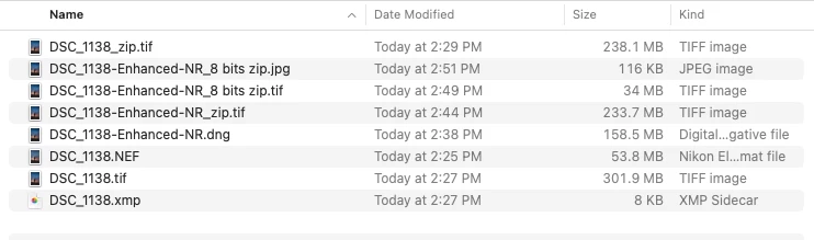

Something is wrong then. A 50 MP 16-bit tiff will clock in at 300 MB uncompressed. More if you include the needed previews. Lossless LZW or ZIP compression can only do about a factor of 2 so ~150 MB is what you expect. No real way around this. If you lower bit resolution to 8 bits then you expect about 75 MB. Here is a quick example for a 45 MP raw file I had laying around on the computer I am on right now to show you what you expect from the basic math:
 You see the 14-bit raw file is about 53.8 MB exactly like you expect for a losslessly compressed mosaiced raw file (uncompressed you expect 45*14/8= 79 MB - lossless compression brings this down to 54MB). A 16-bit tif file saved directly from this with LZW compression is 301.9 MB which is actually bigger than the expected 270 MB which often happens with LZW compression when there is not much to compress and there are previews included in the tiff. This is just opened straight in Photoshop from the raw file and saved as tiff straight from there. No layers, etc. With ZIP compression the same image clocks in at 238.1 MB. Zip compression is usually quite a bit more efficient than LZW on real images but you don't get a factor of two on this particular image which is nothing special.  When you now go to the enhanced dng, it clocks in at 158.5 MB. Smaller than the tiffs created directly from the raw file! dng compression is more efficient than either lzw or zip compression plus the fact that it is denoised makes that the image is now more compressable. Saved as a tiff with zip compression the denoised image is 233.7 MB. Still bigger than the enhanced dng! This is very much expected because dng compression is more efficient than zip. If you downsample this image to 8 bits and save as zip compressed tif, suddenly the filesize drops to 34 MB. This happens because it throws away a ton of info to do this. So really you can only get a smaller file by going to 8 bits.
This is very typical for what I am seeing with most images. The denoised dng files are very efficiently stored even while including the original raw data. Filesizes are smaller than tiffs from the same. Only when you throw away most of the data and go to 8 bits will you gain much space.
