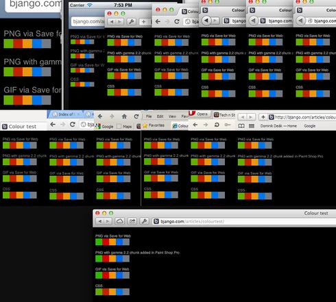

** All the browsers I've tested display PNGs and GIFs according to the raw values contained within the files, with the exception of Safari 6 (just released a couple of days ago, more details below). **
–––––––––– Browser tests ––––––––––
Here's the browsers tested, using a PNG, PNG with gamma chunk of 2.2, GIF and CSS:
iOS 5.1.1 Safari
iOS 5.1.1 Safari - iPhone Simulator
OS X 10.7.4 Safari Version 5.1.7 (7534.57.2)
OS X 10.8 Chrome 20.0.1132.57
OS X 10.8 Firefox 7.0.1
OS X 10.8 Firefox 12.0
OS X 10.8 Firefox 14.0.1
OS X 10.8 Safari 6.0 (8536.22)
Ubuntu 10.10 Firefox 3
Windows XP-x64 Chrome 20
Windows XP-x64 Firefox 14
Windows XP-x64 IE 8
Windows XP-x64 Opera 11
Windows XP-x64 Safari 5
I also tested the same PNG in an iPhone app
iOS 5.1.1 app - iPhone Simulator
I don't have a grab of the iPhone app running on the device right now, but trust me when I say it's the same — I compare screen grabs from the device with my PSDs all day, every day and they always match perfectly.
Here's a composite of the important parts (all identical except Safari 6, which is at the bottom):
Here's the test web page, containing the colours as CSS, a PNG and a GIF image:
http://bjango.com/articles/colourtest/
And all the original screenshots:
https://www.dropbox.com/s/l35dbcrgu7i...
Except for Safari 6 (info below), every single browser rendered everything exactly according to the HEX values typed into the PSD initially. PNG, GIF, CSS across many browsers and versions are identical.
Safari 6's CSS did match the other browsers, but the PNG and GIF images did not.

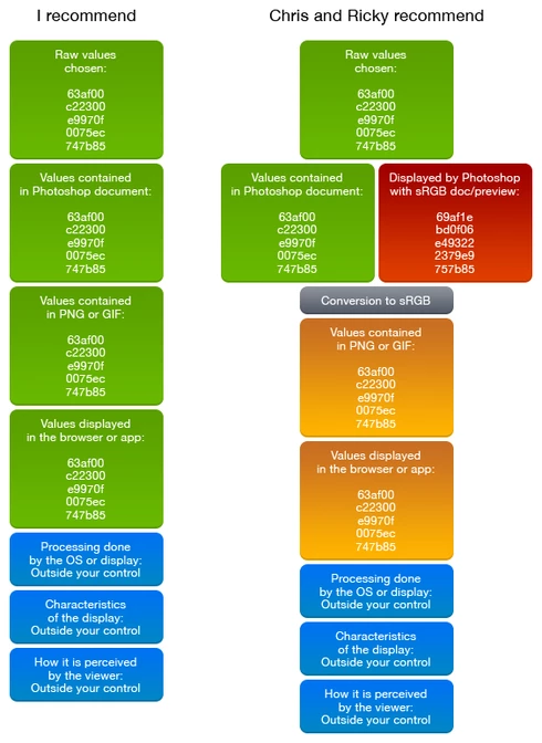

–––––––––– No RGB management vs sRGB all the way ––––––––––
There's two setups that are being advocated in this discussion.
I recommend:
Working Space / Proof: Monitor RGB / Off.
Document profile: Don't Color Manage This Document.
Convert to sRGB: Off.
Chris and Ricky recommend:
Working Space / Proof: sRGB.
Document profile: sRGB.
Convert to sRGB: On.
Here's how colour values are tracked throughout those workflows. Please note (again!) that we're talking about PNGs and GIFs saved using Save for Web, so they *can not* have profiles.
The numbers in the red box will change depending on your monitor profile.
If your document is tagged sRGB and you're exporting with Convert to sRGB turned on, your values are being exported unchanged (converting from sRGB to sRGB will not change the values, unless there's a rounding error in the conversion).
Colour management is all or nothing. You can't make some blind conversion when you're saving an image that doesn't contain a profile. And remember, for user interface design colours in images MUST match colours in code. That's essential.
–––––––––– The important conclusion ––––––––––
In Chris's recommended setup, Convert to sRGB does nothing. In almost any other setup, it will damage every exported file.
Please remind me again why the option is turned on by default?

The color temperature of my display is different from my iPhone, which the camera accentuates, but it looks much closer in person.
This is why I *only* rely on device testing, done with Skala Preview (software we developed). Nothing trumps seeing the actual results in situ. You simply can't argue with that... it's the final result in place, with everything taken into consideration.
Also, in your iPhone example, both your proof and sRGB examples are miles off the iPhone.
July 27, 2012
Sorry, forgot to mention: Use sRGB as your main working profile, then set your Proof Setup to Monitor RGB. Then there will be no color translation in any direction.
Again, however, the recommended workflow for web is to work in sRGB throughout.
