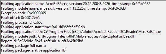

After this upgrade everytime we open AcroRd32.exe it crashes.  Consistent across our network with anyone on this build.  Win10 systems.  This is the event that appears in the Application Log when it crashes.
Disrupting transactions heavily.  Is anyone else seeing this today?

Are you by chance running Malwarebytes Anti-Exploit?  I've asked them to look into this as well on the off chance it's that application.  They are also working with us so far on this.  Being they are co-operating they at least think it could be them as well at this point.  🙂

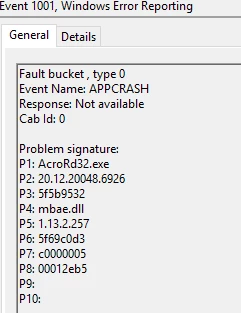

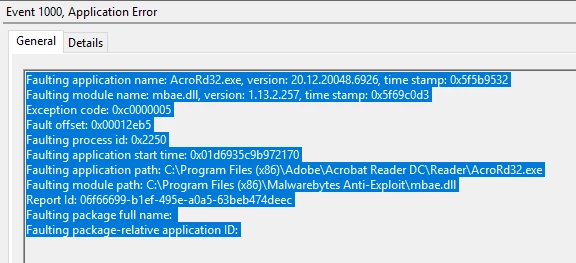

September 29, 2020
What do your windows application event logs show when Adobe crashes?  We are seeing the following:
