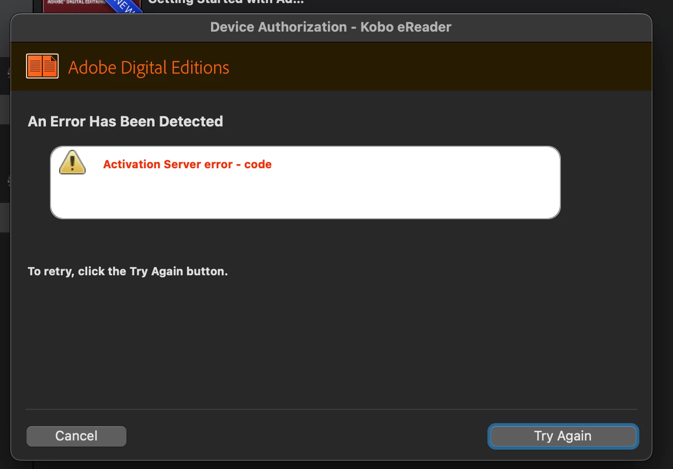

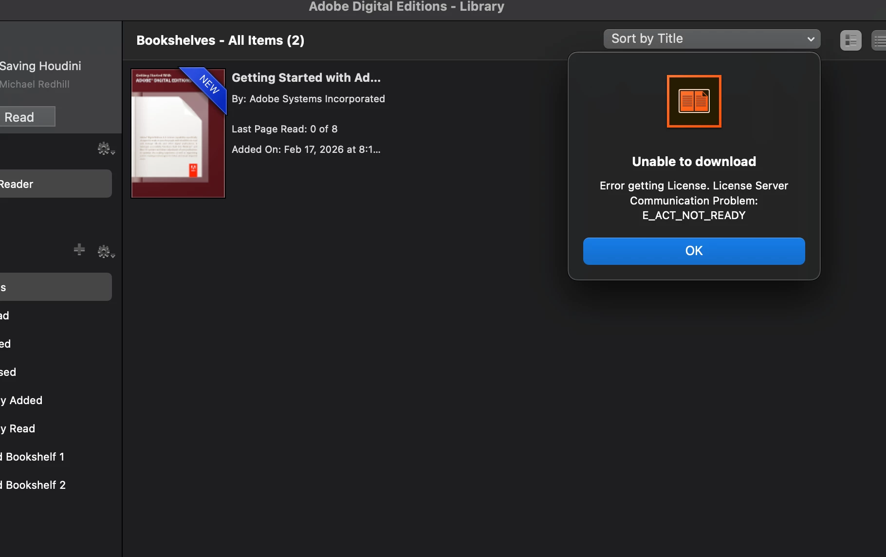

    AquariusMoon84
    February 18, 2026
    It sounds like what I’m running into. I got a brand new Kobo and was so pumped to get it going…..and when I tried to authorize it...this is what I get...
    And it sounds like you are getting this too….
