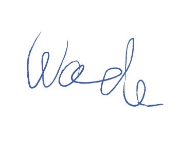

Use one of the brushes from say the Artictic Library and say one of the charcoal brushes like this
MonaOgaAuthor
August 15, 2012
Dear Wade
This looks great, could you kindly share some insight on how you managed to do that? I tried to use that brush but it looks nothing like it.

Monika,
Try different brushes and different stroke weights:
