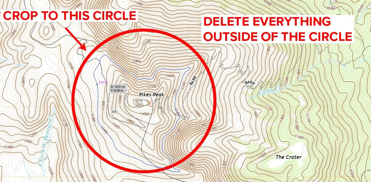

Best way to delete everything outside of a circle in a large editable PDF?
  • December 28, 2021
  • 返信数 7.
  • 2929 ビュー
I have bunch a large editable PDFs with which I am only trying to use a small portion of. They are vector topographical maps with millions of anchor points, and is therefore slowing down my computer immensely.
What would be the easiest way to put a circle around a certain portion of the map, and delete everything outside of that circle? I haven't been having much luck with the pathfinder panel or eraser tool.

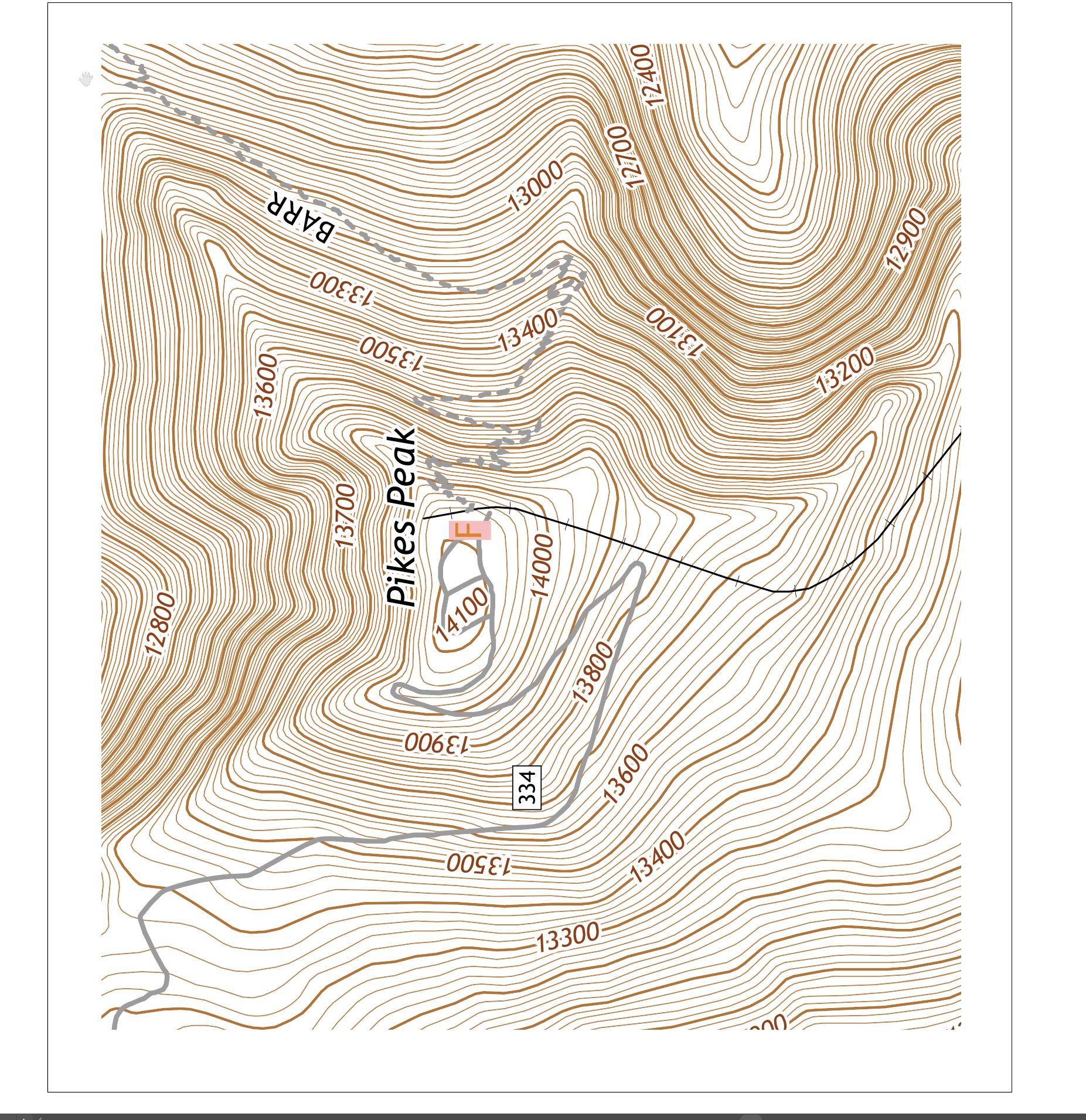

I was able to simply the art somewhat.
This is my end product:

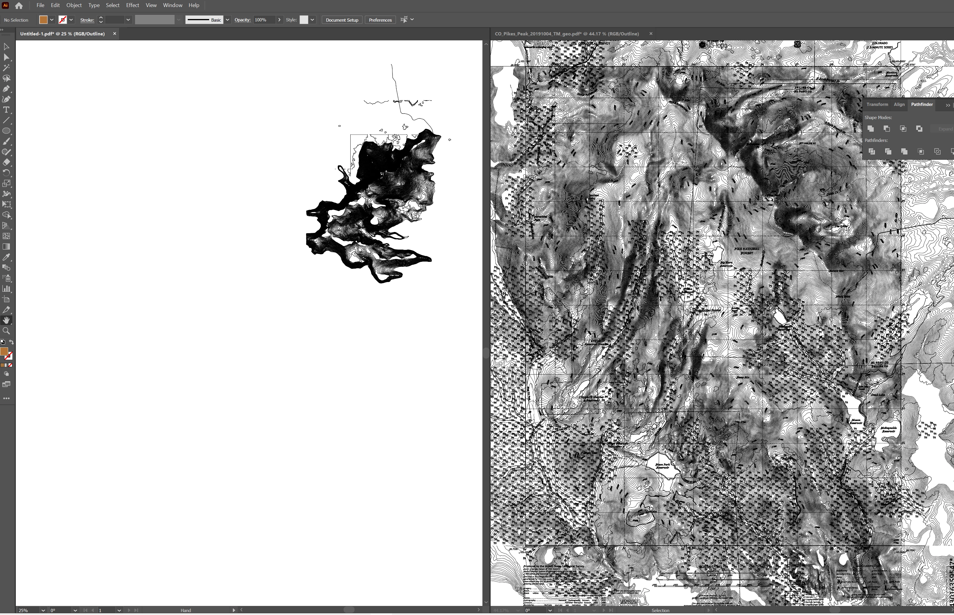

Here is an Outline view of the edited file vs the original (I tried to keep them at relative sizes):
I brought the PDF into InDesign and printed it to the Adobe PDF driver. Not the best workflow, but it worked. Basically, anything that was showing up inside the crop area stayed intact. I tried cropping it and removing hidden data in Acrobat but the image rasterized (an old bug).

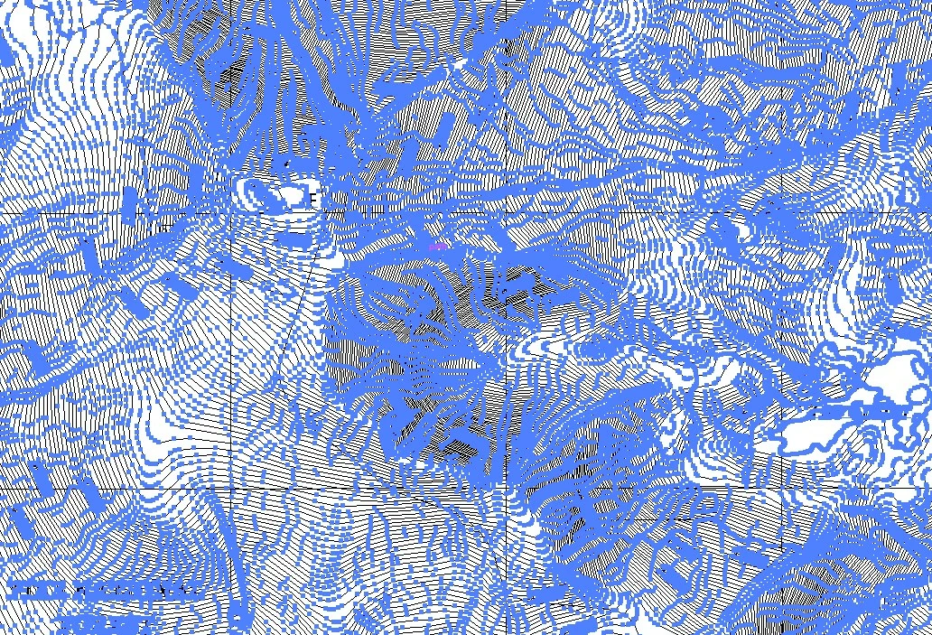

Example 1 - Area I want to crop
Example 2 - Outline mode with tons of anchor points
