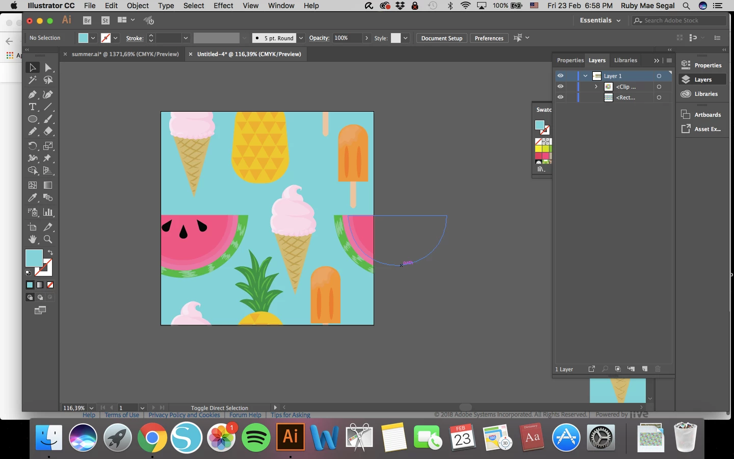

I've been having trouble making seamless repeating swatches because I'd design the pattern, make a clipping mask for it, but then I go and crop it using the crop tool in pathfinder and suddenly all my small details I drew with the pencil tool will disappear!
Why is this happening and how can I stop it?

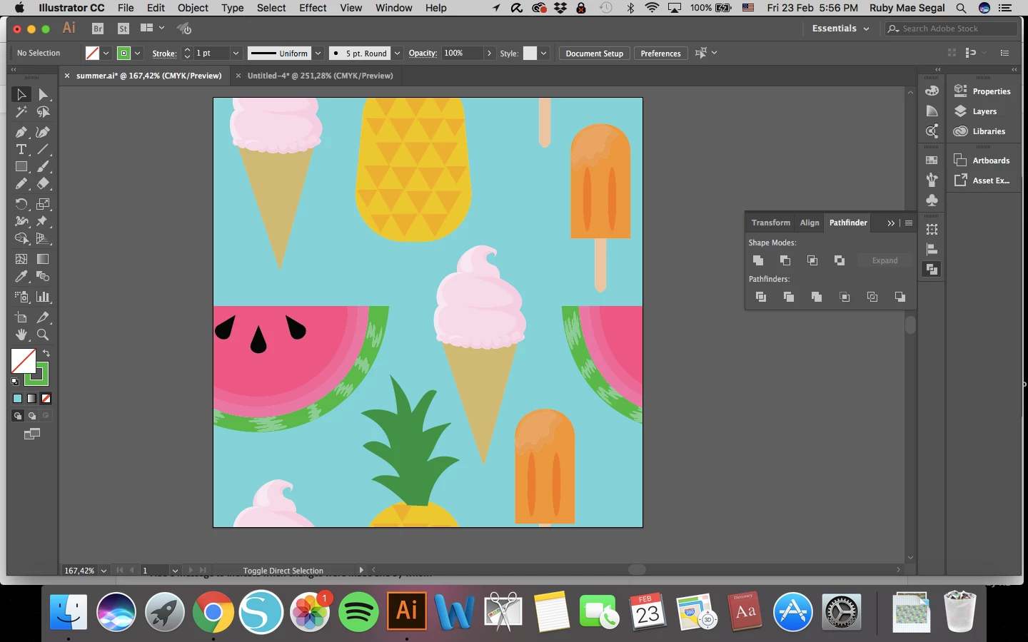

here's my finished swatch (not rasterized) with the clipping mask applied

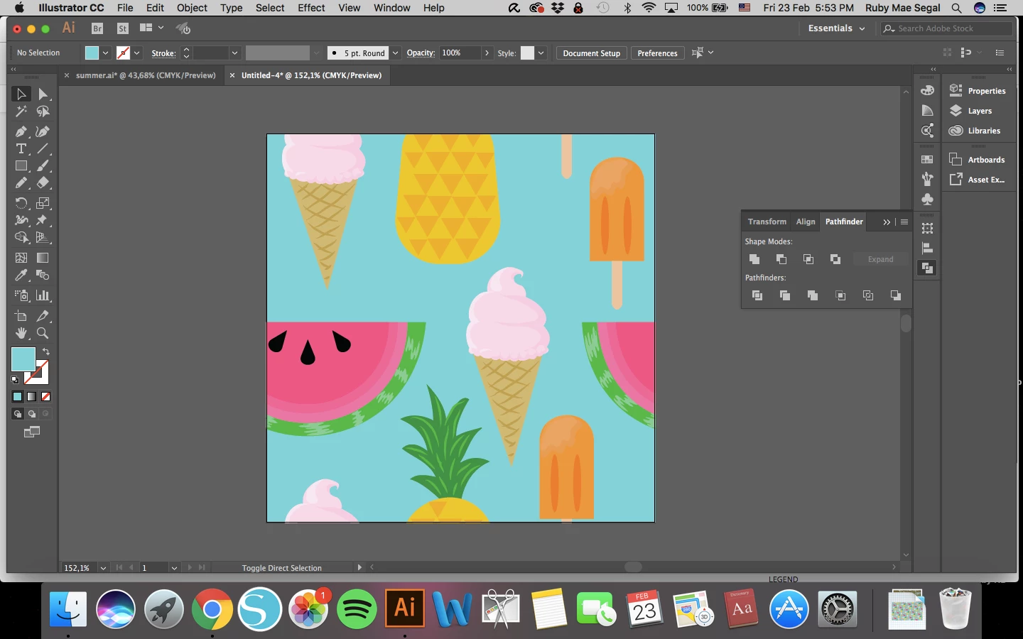

And as soon as I crop it so that it can act as a swatch It deletes the small drawn details on the ice cream cone & pineapple
