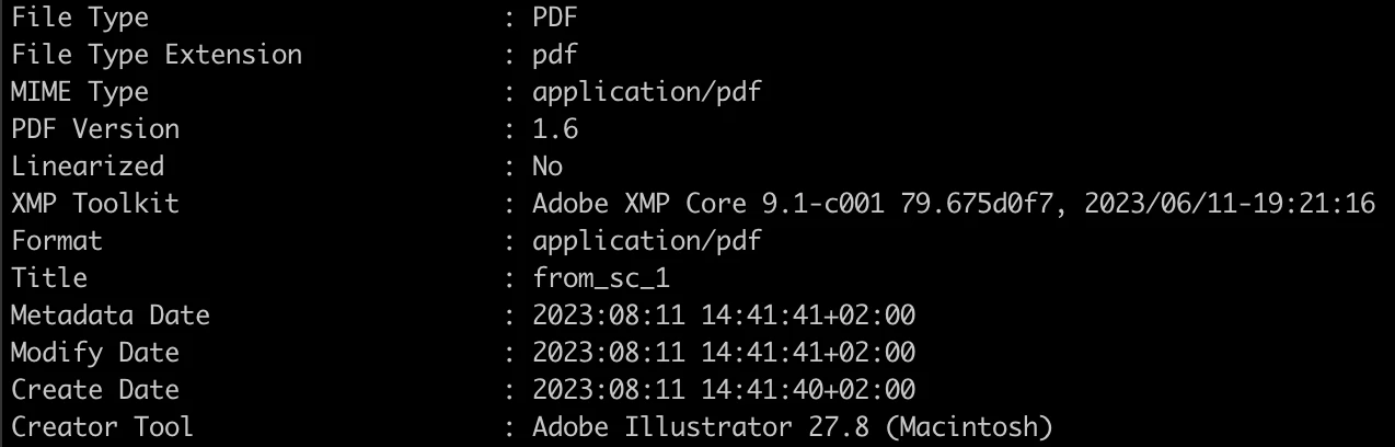

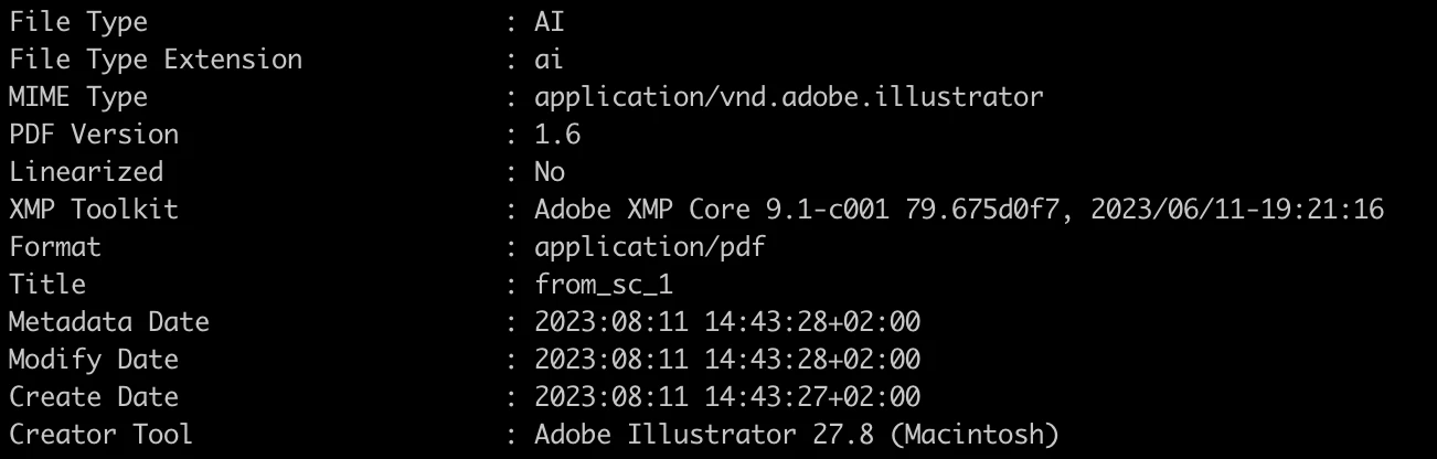

Hi, there's a strange behavior regarding mimetype when saving an .ai file with more then 10 artboards.
Checking the mimetype using exiftool, if the .ai has more then 10 artboards, its mimetype is application/pdf. If there are fewer artboards, its mimetype is application/vnd.adobe.illustrator. This data is used later in an internal flow, so it is important that the mimetype is consistent.
The file is saved in a local folder, and it can be replicated by just creating a new document from scratch. I've tried to save it with or without 'toPdf' conversion but nothing changed.
AI version: 27.8
Replicated either on Mac and Window machine.
I've attached the screenshot of the log for either mimetype. Adding or removing the last artboard you could replicate the behavior.
It's a bug or some kind of internal limit regarding how AI file are saved?
Thank you

I’ve prepared some data, 10_artboard.ai, and 11_artboard.ai with 10 and 11 artboards inside, and the screenshot of the metadata of those 2 files.
https://shared-assets.adobe.com/link/5dd96ee4-9d0a-406f-4e85-d71163acf870
From your shell use the command
exiftool <filename>
And check the result.
10_artboard.ai (correct file)
  • File type: AI
  • File type Extension: ai
  • MIME Type: application/vsn.adobe.illustrator
  • XMP Toolkit: Adobe XMP Core 9.1
  • Format: application/pdf
11_artboard.ai (incoherent metadata)
  • File type: PDF
  • File type Extension: pdf
  • MIME Type: application/pdf
  • PDF version: 1.6
  • Format: Application/pdf
Both of this are generated From Adobe Illustrator 27.8 (I've tried also on 27.7) and have the same error.
