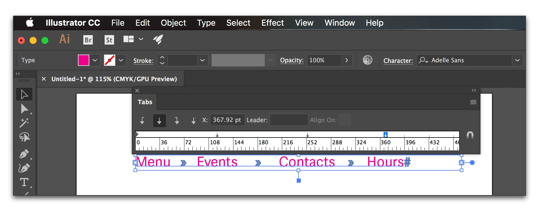

I am using Myriad Pro and when I type I am trying to make a large gap with the same spacing using the tab button.  When I do this I get different size gaps between different words and i can not figure out why.  I have not set any tabs or anything like that.
As you can see the gap between menu and events looks normal and the gap between contact and hours looks normal but what happened between Events and Contact???
Please help, I don't remember it doing this before and I wish it would work.

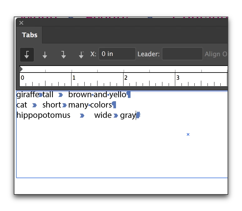

解決に役立った回答 Ton Frederiks
When you set no Tabs manually, the default position is every 36 points. So when you use the tab key, the next word aligns on 36 points when you use the Tab key again the next word goes to the 72 points position, if possible. If some words are longer than 36 points then the word after that will jump to the next 36 points position.

Andydreads作成者
January 8, 2017
It's ok.
See the issue is when i just use the tab key to space out my type it makes gaps that are different sizes, is there not a default gap size when using it.
I have not set any tab stops so why are the gaps different sizes??
As you can see the last gap (between People and Contact) is bigger than the rest for no reason.
If there is a reason could someone explain?
Thank You in advance.

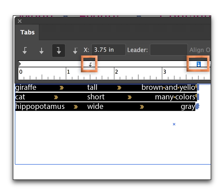

Hi Andy: Illustrator doesn't have default tabs, so the text just goes where Illustrator decides to put it. For example:
If you select the text and take a minute to add the tab stops, you are taking over the control, and not just the position, but also the alignment. Illustrator offers 4 tab alignments (left, right, center and decimal).

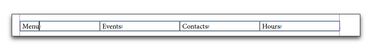

In InDesign, you need to set tab stops to control the spacing. Select the text, and then Type > Tabs. Add three tab stops above the ruler. (Click to add, drag to reposition, drag down to remove.) Be sure there is one tab character between each column.
Alternatively, select the text and choose Type > Convert Type to Table.
