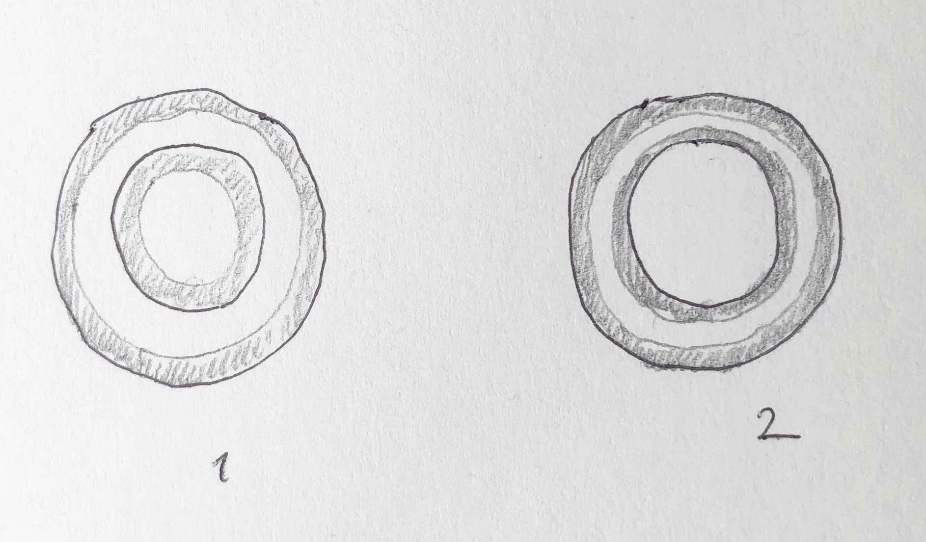

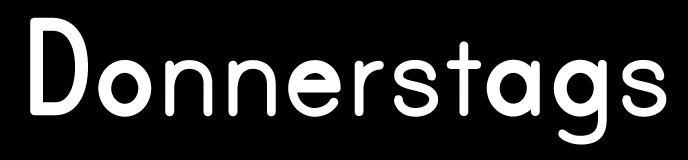

I create outlines out of type (Type > Create Outlines) and then assign a stroke weight. In the Stroke panel, I set Align Stroke to Align Stroke to Inside. It does that in open line shapes (I, 2, 3, E …) but on any shape with an enclosed form—a counter—such as O, o, e (the upper part of the e) etc., it seems to interpret Inside as: Inside the counter. However, the outline does circumscribe a closed form who's outline it is (if I’d pour colour into the form the outline circumscribes, I’d end up with the proper letter from which it is the outline—which is exactly what happens when choosing to Fill that outline). Now, how do I get InDesing to align the stroke inside the form circumscriped by that outline and not inside the counter? If I’m not clear enough, please have a look at the images attached. In the little hand drawing, 1 is how it looks, 2 is how it should look.

When converted to outlines, type with counters becomes a compound path, so basically this is expected behavior and the reason that only aligning the stroke to center is viable for type.

After converting to outlines, you next might try to select the compound paths and release the compound paths. Now you can set individual paths to inside or outside, and you wont have the even/odd rules interfering.
