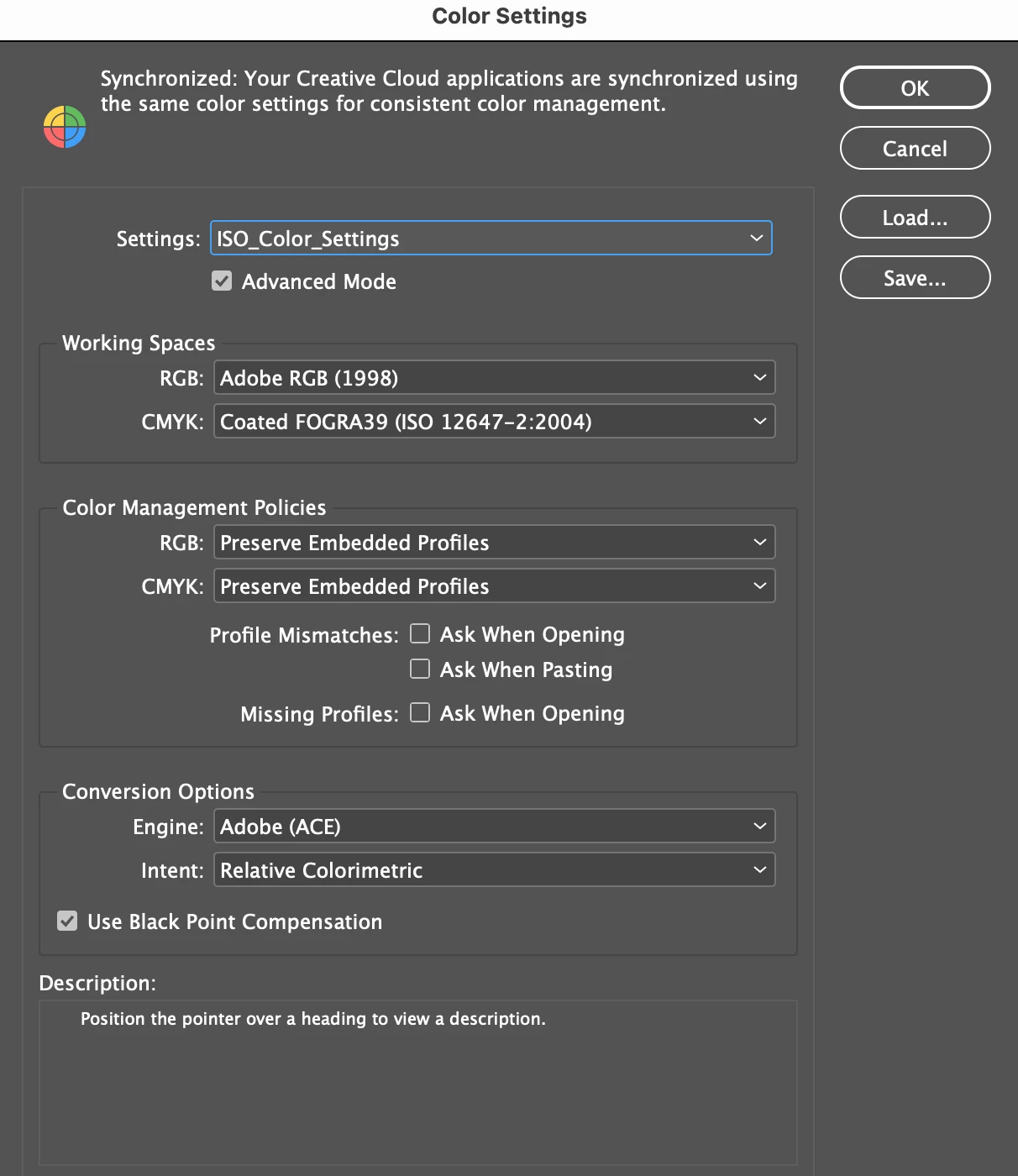

This looks like the recent color management bug that happened with some recent CC2021 updates where the InDesign Color Settings gets set to Emulate InDesign 2.0, CMS Off.
If you were not aware that your Color Settings CM was turned off, and created a document, it would have no profiles assigned (the InDesign file you posted has no profiles) . Try assigning your Adobe RGB and Fogra 39 profiles via Edit>Assign Profiles..., and then export to PDF/X-4.

Bitte posten Sie sinnvolle screenshots, die alle relevanten Panels einschließen.
Welchen Color Mode hat die Farbe – CMYK, RGB, …?
Was waren die pdf settings beim Export?

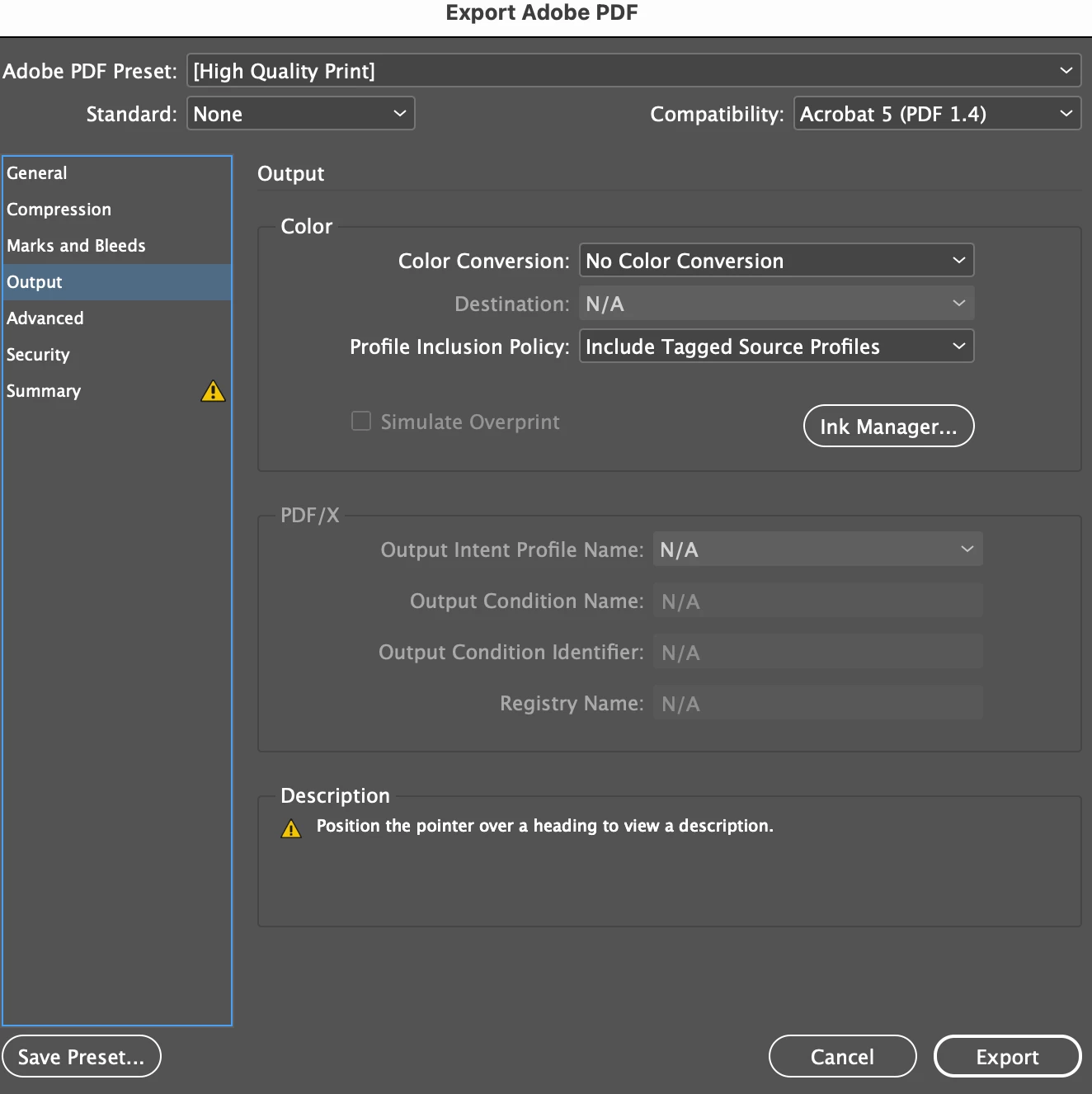

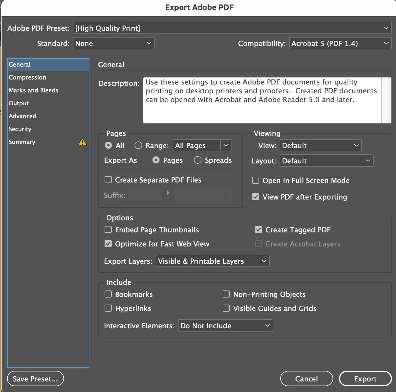

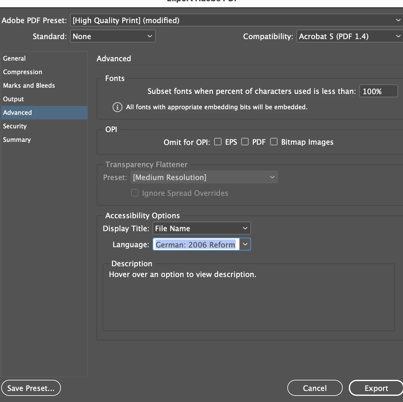

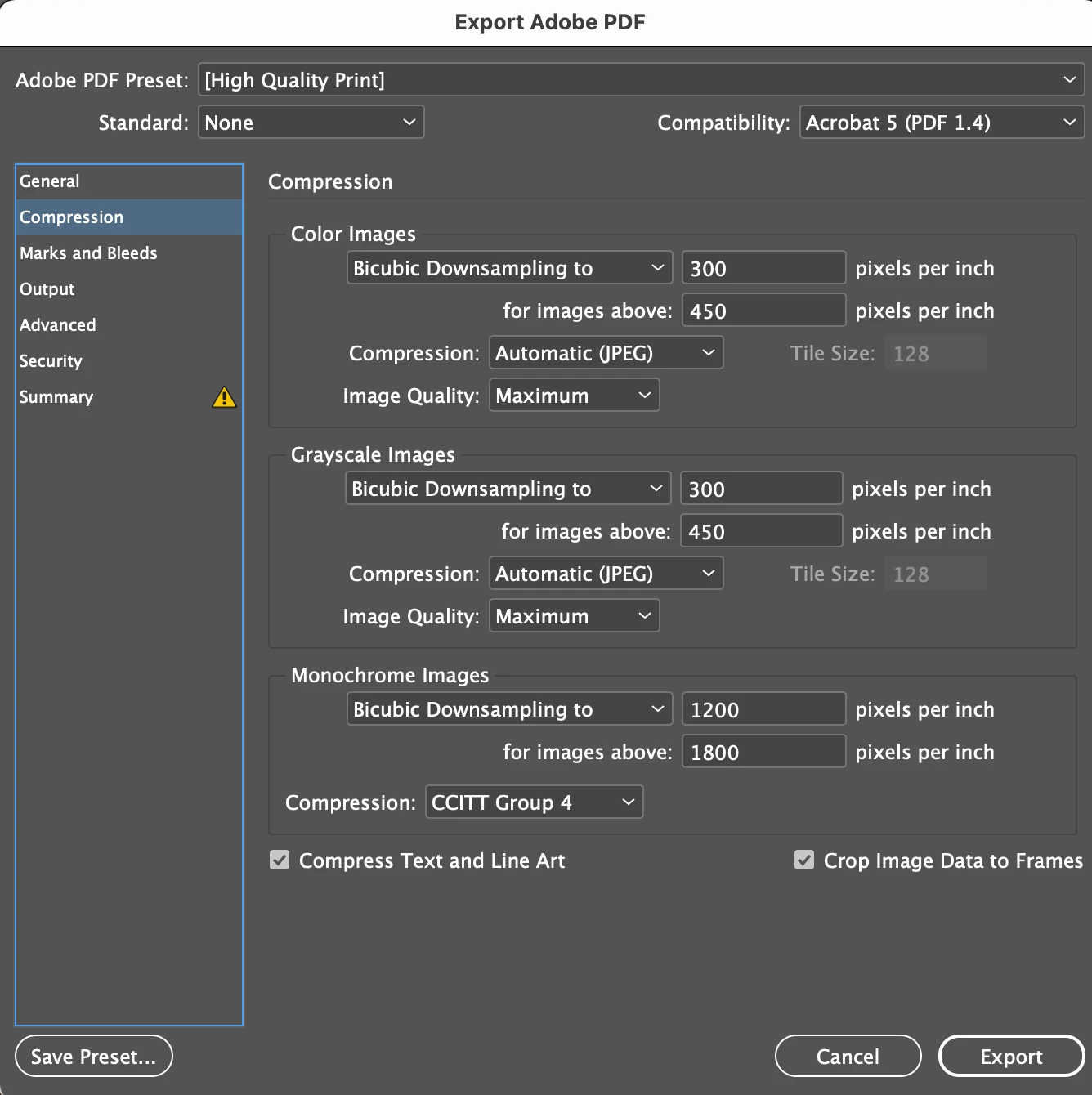

Vielen Dank für Ihre Rückmeldung. Ich füge die Screenshots bei.

Why did you remove Color Spaces from the document? (see »Screen Shot 2021-04-28 at 10.17.39.png«)
The pdf has no Standard (like PDF/X-4), so it will have no embedded Output Space and Acrobat will use its default Color Space for display.
