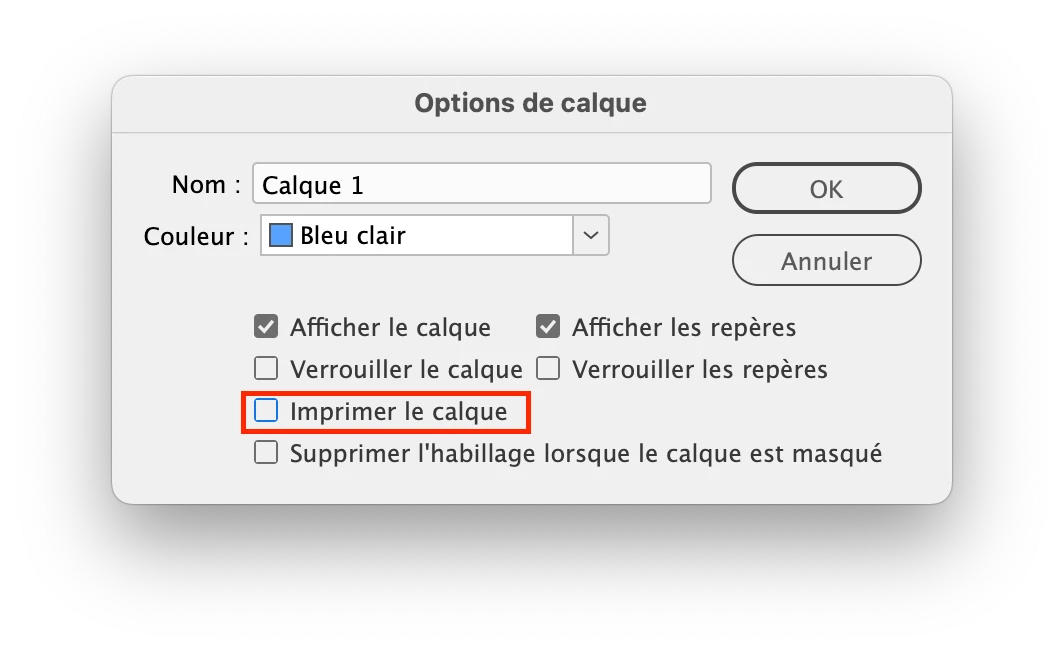

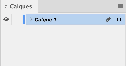

You can put them on a non printable layer:
Untick the checkbox. You will notice that the layer is now displayed in italics, indicating that it won't print.
