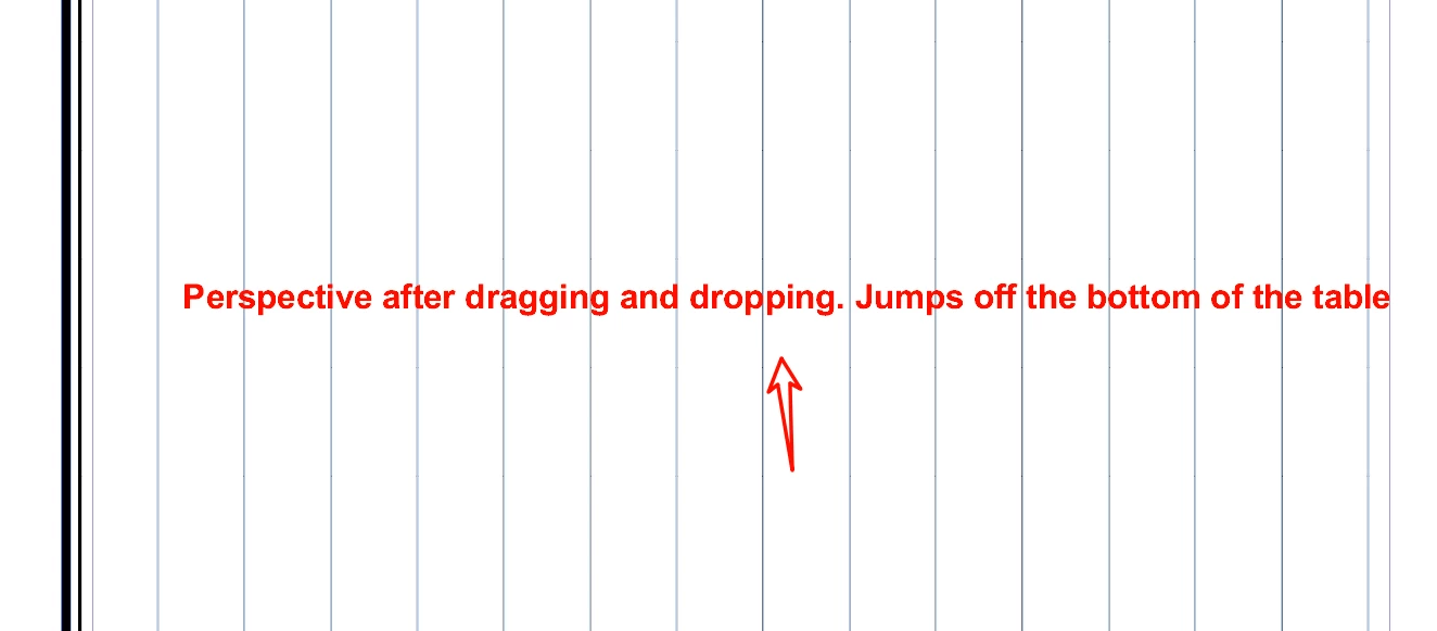

How do I get the ID window view to not jump when dragging the bottom edge of the table line?
  • May 13, 2025
  • 返信数 2.
  • 272 ビュー

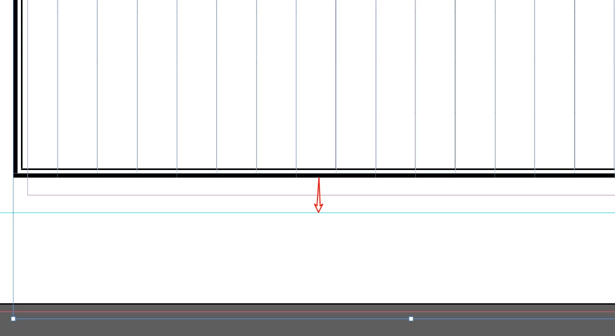

I am trying to drag the bottom edge of the form to align the reference line, but when I do, the view jumps to the center line of the form.

Select that first one row and change the At least. You cannot simply drag a bottom of row down when it is set to At Least. You might try to set it to Exactly some value

May 16, 2025
Hi dub,
Your example table has only one row and its "At Least" height is set to 323mm (about 12 inches). If you try to drag the bottom edge down (which means add a row) the resulting row is too tall for the page; so the overly tall row will not show.
Try changing the "At Least" height to something smaller.
