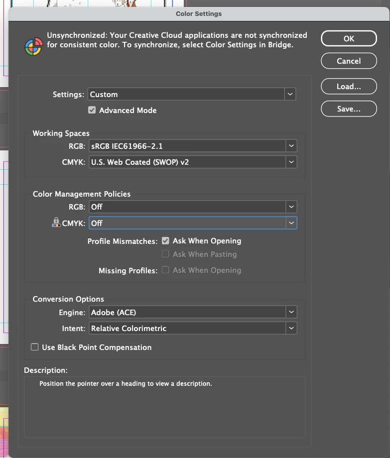

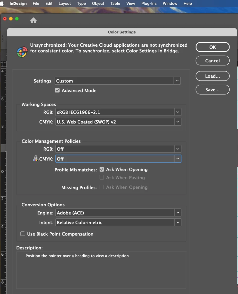

Hello.  Thank you for your reply.  I set the CMYK profile to U.S. Web Coated (SWOP)v.2.  This is the recommendation from Ingramspark, at least for its premium color hardcover, which uses coated paper.  I will double check the settings requirement for the Paperback version again, thank you.
If anyone has advice about what the color settings should be for Photoshop and InDesign on this type of project, I would greatly appreicate the input. I'm attaching screenshots of the Color Settings as they are currently set.

@Dave Creamer of IDEAS OK. I can see that they don't want to risk a profile conversion, but it sure would be nice if they told you what CMYK profile actually matches the print condition so your colors will be somewhat accurate.
This is definitely a droip it in the hopper and what comes out comes out operation.
Thank you!  I bought a color calibibrator for my monitor. I am going to go through one more time and see if I can get the darks below the 240% ink limit without causing too much loss.
I have a PDF from my client of a different children's book with full bleen illustrations on many pages. It looks decent even though is was printed with Ingramspark.  Interestingly, the images have several areas that read over the 240% limit Ingramspark claims to require.
If I convert to a custom CMYK with an ink limit setting turned on to 240%, convert all files, and then convert again to standard working CMYK, would I lose data in process?
