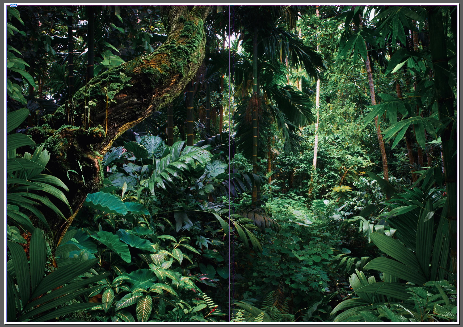

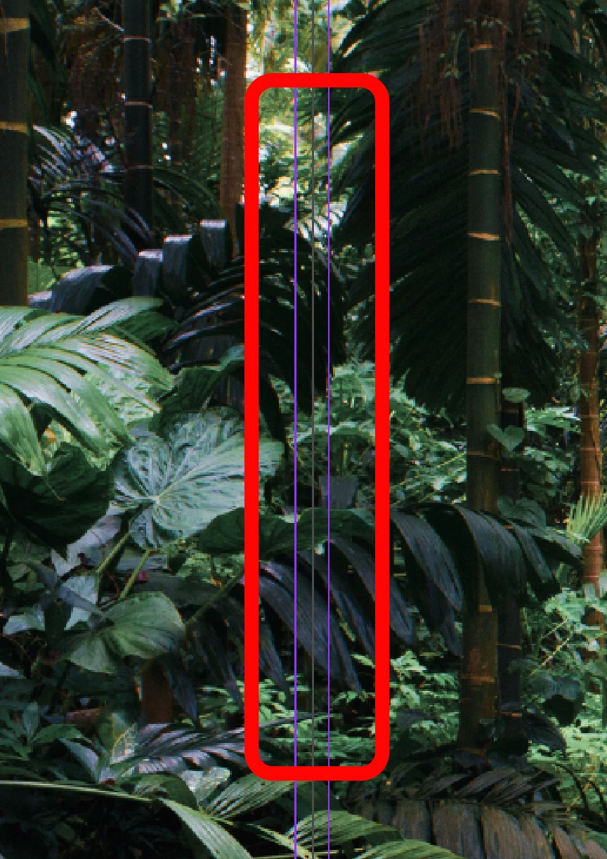

I am about to create a brochure and have the following problem: I have pictures that should fill a double page fluently and now need to add a 2mm edge for printing. How should proceed? Do I have to split the pictures in the“middle” of the double page and leave the resulting space white? If so, how do I do it best?
Edit: The company responsible for the printing needs the file as pdf.
Thanks in advance for any help.
Images attached.

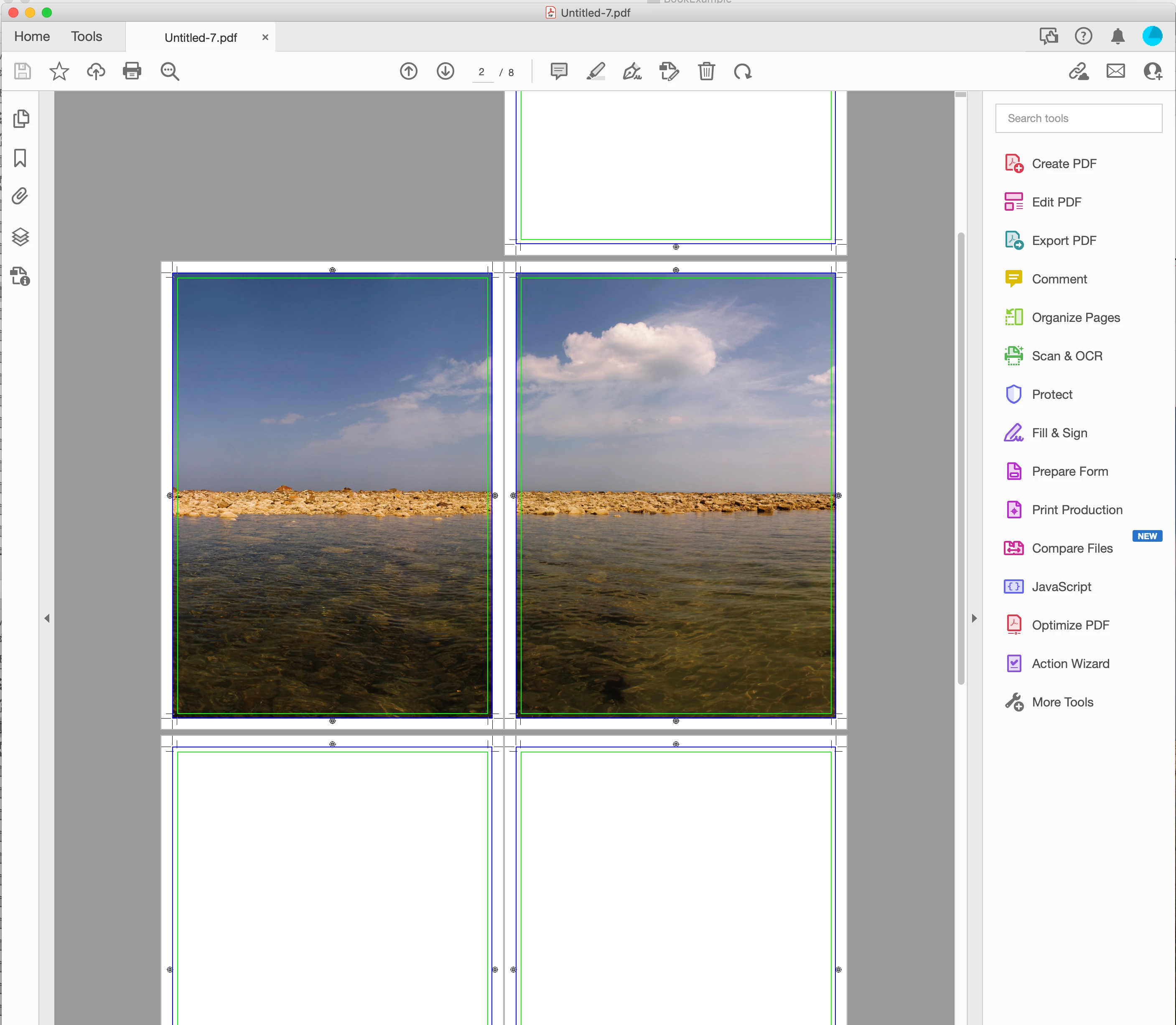

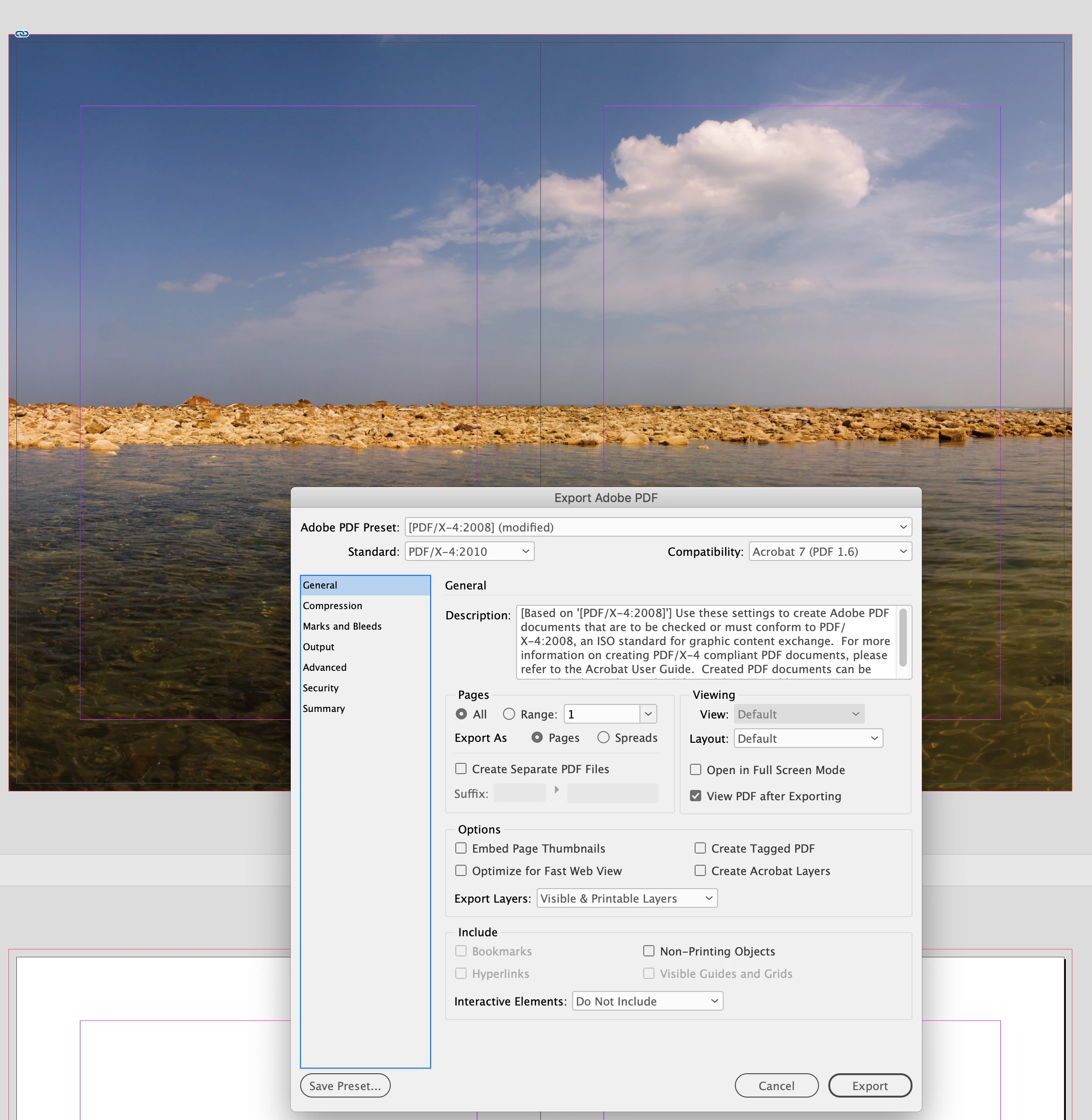

When you Export the PDF choose Export As: Pages in the General tab:
The exported pages in Acrobat:

What I don’t understand right now is how the whole thing gets cut in print. I ignored the border “in the middle” on double pages as shown above, but you probably need that, right?

Don’t split the image, just run it across the spread. When you export the PDF the export should be to pages not spreads, so with or without an inside bleed the spread will get divided into two pages.

Set the inside bleed to zero.
