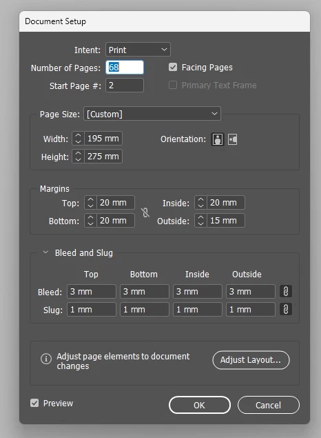

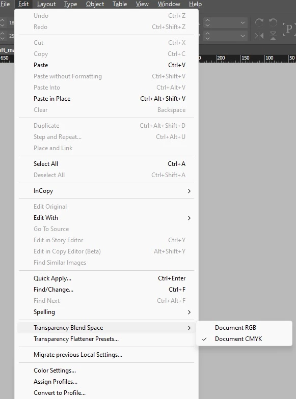

December 15, 2022
You might experiment and see if all the elements on your page agree as to basic color model. I like to be all one way or all the other when it comes to graphics being RGB or CMYK. Also check under Edit > Transparency Blendspace as to which way it goes. Also, you might check the document setup for intent of either print CMYK or web RGB.
Mike Witherell
MDDSGNR
MDDSGNR作成者
December 15, 2022
Thank you Mike, my document setup for intent is "print" and transparency blendspace is also CMYK. I don't know what's the problem. This is the first time I've encountered such a thing.
