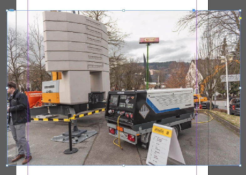

Robert at ID-Tasker
March 21, 2024
I do not think it is about the files themselves. But attached you will find one of them. The problem is occuring with ALL pictures. I have more the feeling InDesign doesn´t find the correct path to the folder where all the picture have been saved and still are.
@stefaniee26877224
Placed without any error messages:
Windows 10, InDiesgn 19..3
