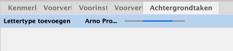

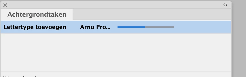

regularly Indesign tries to activate a font in the Adobe-collection which I don't need anymore, because I changed it by anothjer font., but this action keeps going on in the background. result: it is impossible to make a PDF, because Indesign keeps trying to activate that font in the background.
to solve this, I have to close all my open indesignfiles and restart the application.
how can I stop an action in the background without having to restart Indesign...

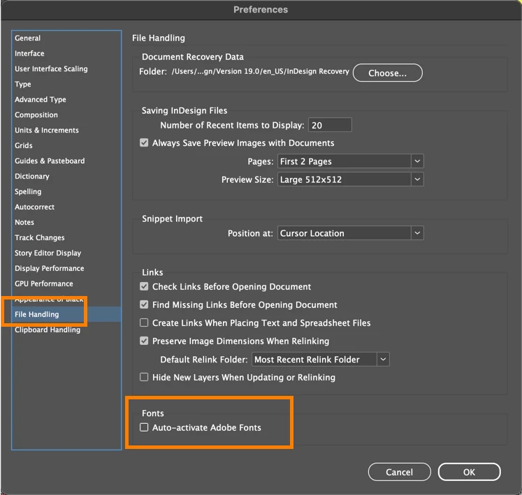

It's evening in the UK, so I don't think we will hear back from @Eugene Tyson until morning, but I think he recommended saving as IDML as a one time thing. If there's corruption in the file like a lingering font reference, it can straighten it out. I first answered early morning in my time zone,  and realize now that Eugene also asked about if the font appeared in Find/Replace font. (Sorry, Eugene!!)

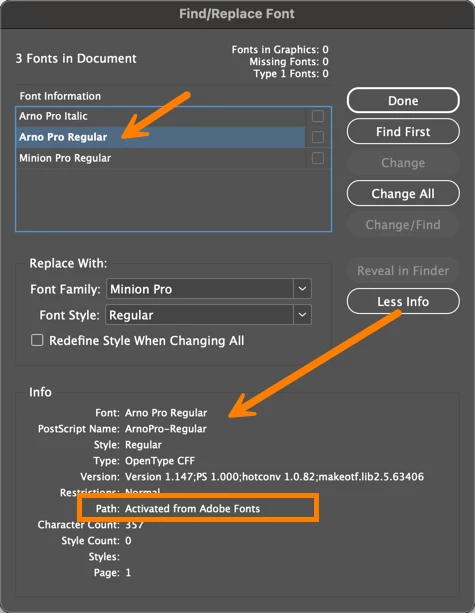

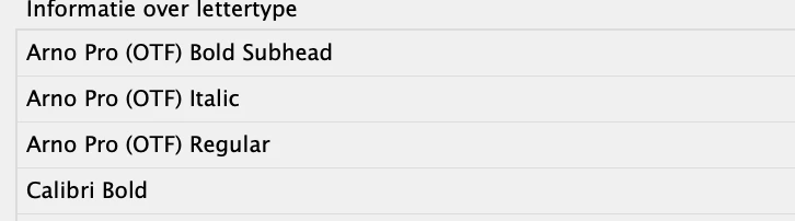

As for your fonts, it looks like you aren't using Adobe's versions of Arno Pro—you likely licensed them elsewhere. Note the difference in the naming conventions and more. Having similarly named fonts from a different foundry can cause issues. Either uninstall your versions from your computer and replace with Adobe's or vice versa.

it is indeed so that I don't (always!) use the Adobe version of a font. in that case, Indesign keeps trying to force me to do so instead. so every time I open that particular file, it's the same 'battle'. 🙂

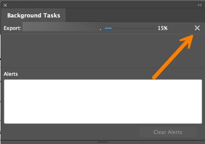

Just clarifying... the X to stop a task is missing from your Background Tasks panel? (Your screen shot seems to be cropped on the right.)

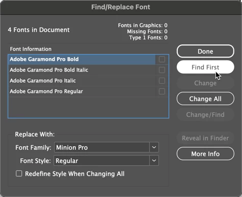

And if you open Type > Find/Replace Font, is the problematic font as being used still being used somewhere in the file? If yes, click the Font name and use the Find First button to locate (and remove it).
Finally, is Auto-Activate Adobe Fonts enabled? Does turning it off help?

I'm working (in this case) with a Arno Pro Bold Subhead (OTF) but indesign goes on seeking to open Arno Pro bold in the Adobe collection... I don't need the bold-version.
there's no X in the corner to stop.

Is the font listed in Type>Find/Replace Font ?
If it is - it might be used by a style or something, so you can remap it there and update your Style at the same time.
By ticking the option
Redefine Style When Changing All
