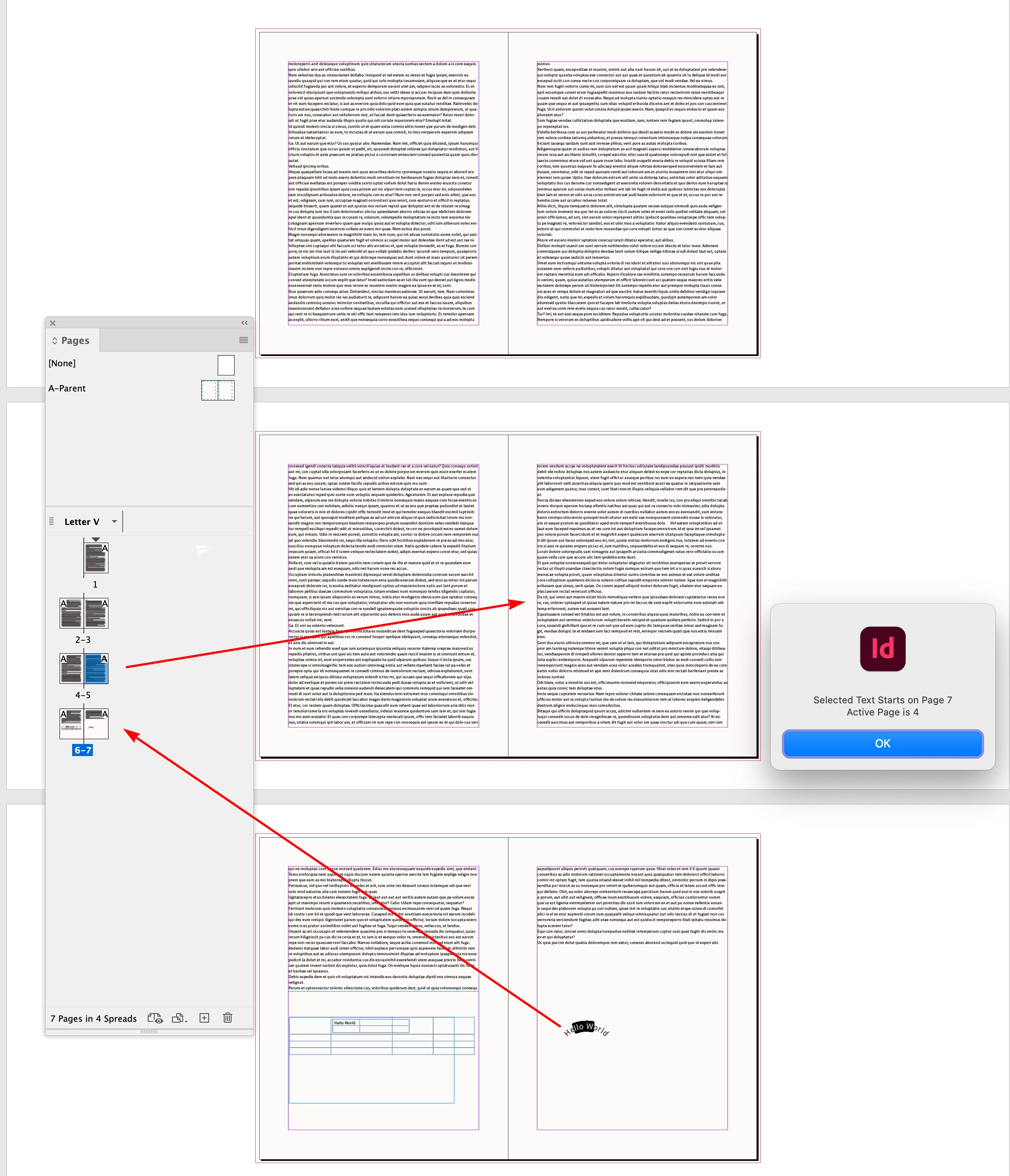

    rob day
    February 13, 2026
    If this is for in-house use it might not matter, but the active page and the selection’s page can be different:
    var ap = app.activeWindow.activePage.name
    var sp = getTextPage(app.selection[0])
    alert("\nSelected Text Starts on Page " + sp + "\n Active Page is " + ap)
