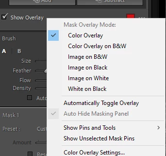

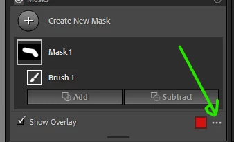

Besides turning mask overlay on and off (O key shortcut) - and only when off, do you see the adjustments themselves - there are different options for masking overlay, selected e.g. from three-dot menu in the Masks panel:
the default being Color Overlay (in which case the current overlay colour, for example in my case red, shows as a square alongside). If set to Color Overlay shift+O cycles through the standard choices of colour. Other mask overlay options include showing the selected picture area on white, or on black, or on a B&W rendition of the photo, or even showing the mask selection only (as a black and white image, with nothing visible of the photo itself).
Also, if you go to Color Overlay Settings in that same menu, there is an option as to whether masking overlays should indicate the selected parts of the photo, or should indicate everyrhing else except the selected parts of the photo.
So between these controls you can show masking however you like. Some of these options have got key shortcuts associated and so are quite possible to change accidentally.
