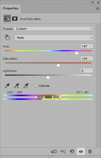

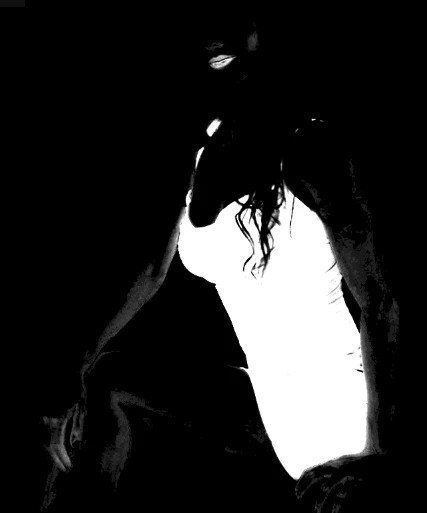

解決に役立った回答 Semaphoric
I used Select > Color Range to select the Reds, converted to Quick Mask mode, and used Image > Adjustments > Levels to isolate the dress, back to Standard mode, and used that as a layer mask for a Hue & Saturation adjustment layer.
There's a bit of contamination in her arms and lips, but it's easy enough to paint out.
In the H&S layer, I set it to adjust the Reds, and moved the hue over to green:
