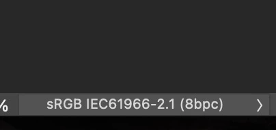

It's the profile embedded in the file.
If the file is untagged, doesn't have an embedded profile, the color is undefined.
Look at the status bar at the bottom of the image window. It can (and I would argue should) be set to show the embedded profile:

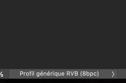

@D Fosse thanks again for all your help, last question : how do I change the profile ? (by the way you are right they are different... See screenshots)

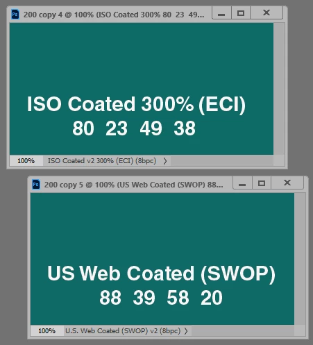

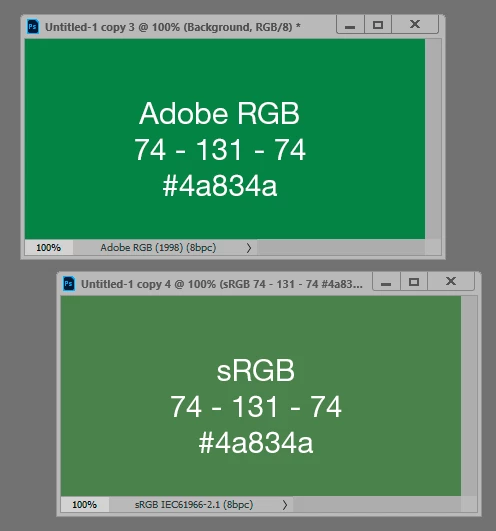

June 1, 2024
Numbers are color space specific. They are undefined until associated with a specific icc profile.
Same numbers, different color:
Same color, different numbers:
