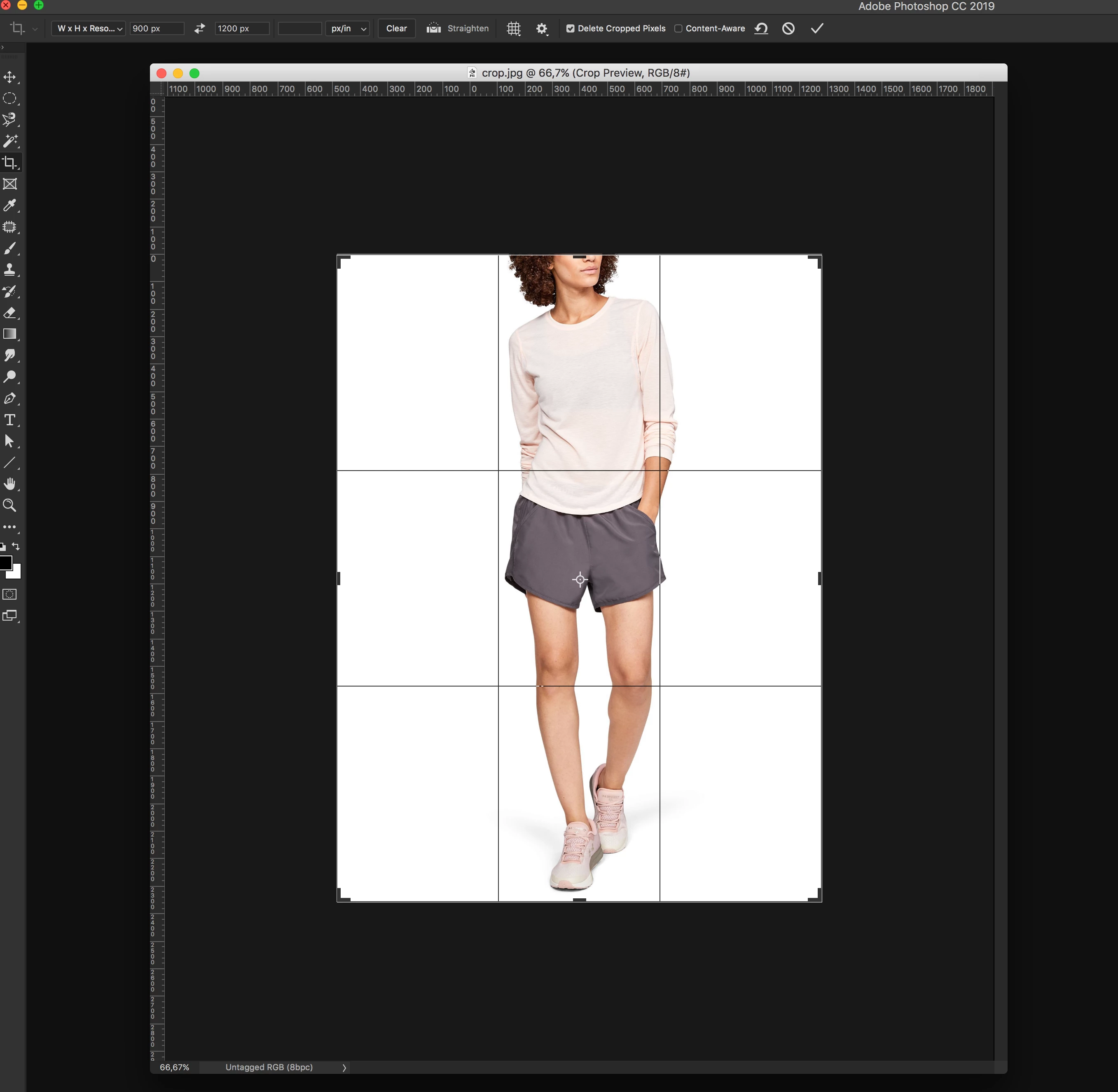

Hey guys,
Wondering if I can automate the cropping of this images using a script instead of an action...
I need to crop it to 900 x 1200px full body
Thank you !

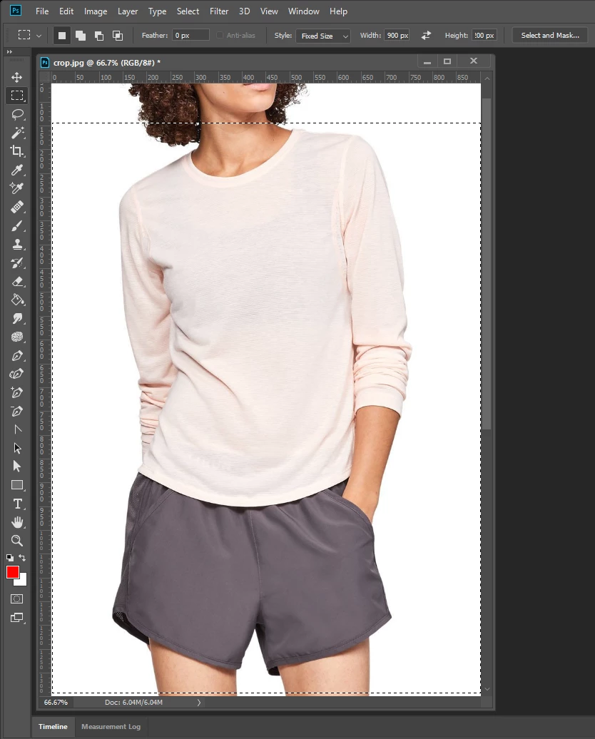

March 19, 2019
As JJMack said, an action can easily do this:
However as you ask for a script, my minor “contribution” would be to simply trim white space based on the upper left pixel, fit image and change canvas size:

Hi geppettol66959005
Thank you, almost there but it's not the full body
JJMack
March 12, 2019
While that image can be cropped like that. How would a script be able to do that? There is no Photoshop feature align selection to subject's full body.  Or a Content aware serarch  find and select full body.
JJMack
