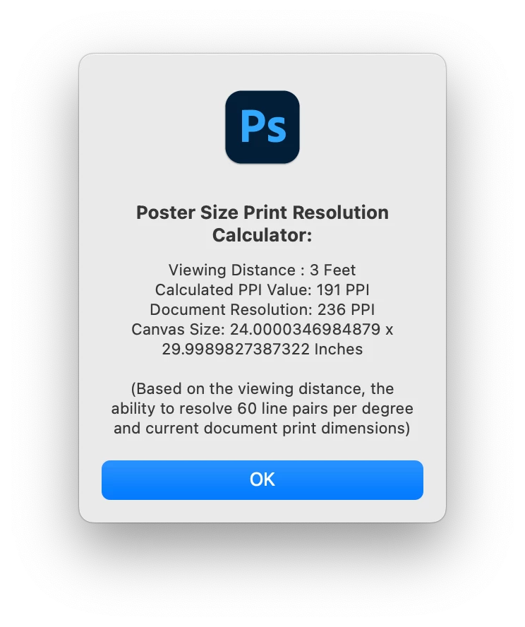

Right now, if I recropped the original image to 5657x7071 px and printed it at 24x30 inches, it would be 236 ppi, which may be fine for looking at it from 36 inches away (the depth of the reading chair). But I can upscale using Image > Image Size and take the image to 7200x9000, at which point it would ostensibly 300 ppi.

236 ppi is more than enough, more than a pair of very good eyes can actually resolve at the intended viewing distance. You will not be able to see individual pixels! I can guarantee you that using the image as-is will look better than an upsampled version. The only valid reason for upsampling is if you can see pixels.
