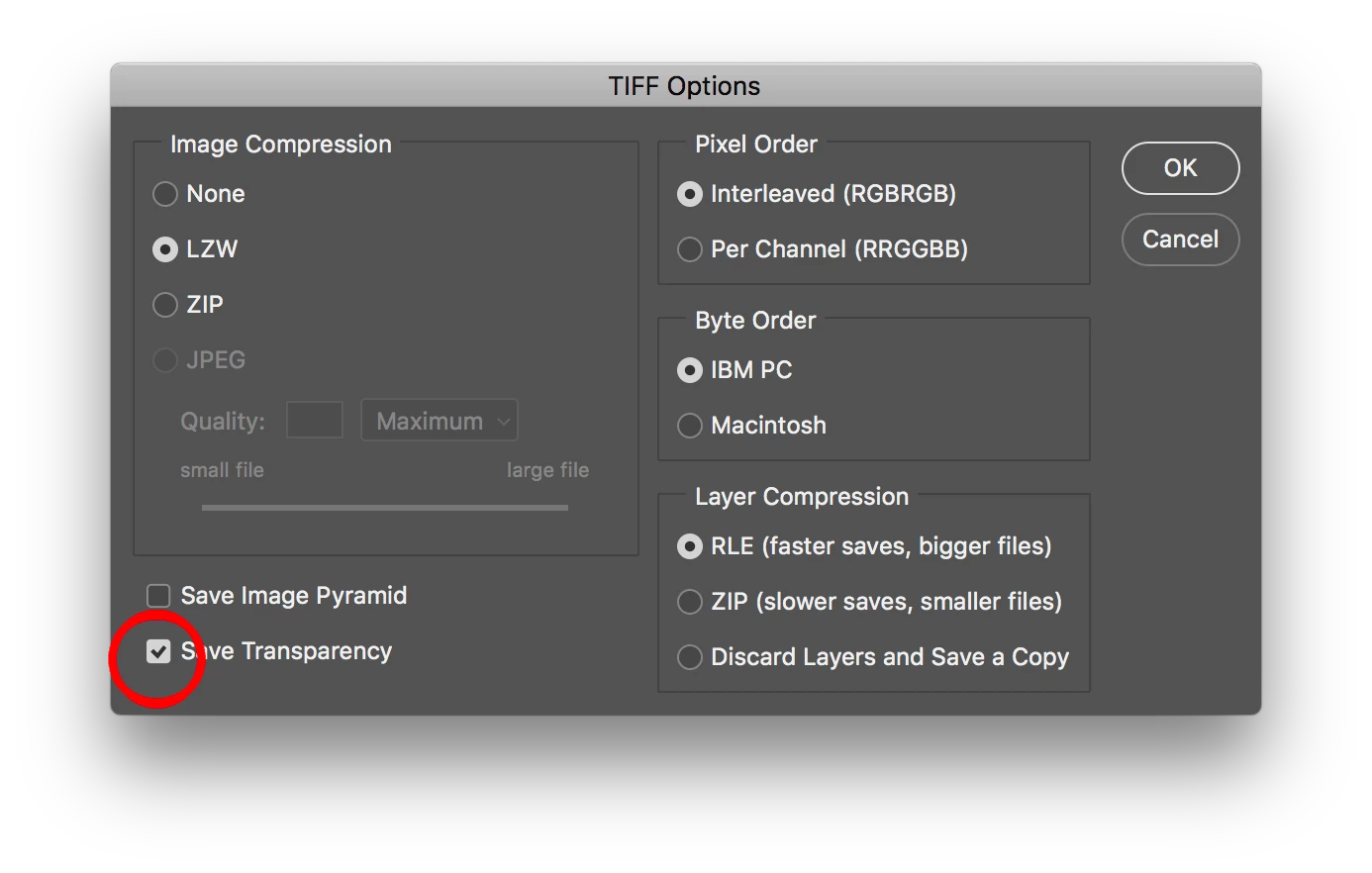

Way to check if 1000s of.tifs are saved with transparency.
Is there a way  to check this setting was enabled on 1000s of files? Such as with bridge, up in the filename, or even down in bottom left of window.
Opening up each file and doing a save as, is really time consuming.

    Stephen Marsh
    July 7, 2018
    Thanks for contributing Rob! Yes, the brute force resave approach is a workable fallback, one does not even need a script to do this to batches of images.
    Rather than testing for transparency, which might not tell you if the transparency save option was checked
    It does tell you if the TIFF transparency option was used when saving, which is the reason that I suggested it. :]
    I performed many tests comparing layered files with/without the transparency checkbox used when saving vs. flat files etc. The transparency checkbox does not have to be used when saving a layered file. However if the transparency checkbox is used, then an entry is written to the file (this alpha channel transparency entry does not result in a physical alpha channel appearing in Photoshop when a file is opened though). This entry is not produced if layers are simply used, which is why the OP rejected my first solution as it was not targeted to the specific situation at hand.

    Mike_Gondek10189183
    July 6, 2018
    Thank you very much for your reply. All the tifs are layered so unfortunately this wont help.
    I need to find which ones are missing the transparency setting, so can flip that setting. Or a script that will turn that setting on.
    Stephen Marsh
    July 6, 2018
    OK, I should be able to come up with an ExifTool solution (perhaps an Adobe solution, but no promises). I’ll look into it and post back later.
    _______________
    The following ExifTool command line code will look for only TIFF files in the main top level folder or any sub-folders under this path. A new folder will be created in each directory/sub-directory titled “TIFF TRANS OFF”. The files without the transparency box checked will be moved the these named folders:
    exiftool -ext .tiff -ext .tif -if 'not defined $AlphaChannelsNames' -directory=%d'TIFF TRANS OFF' -r 'system path to top level folder'
    The following ExifTool command line code will look for only TIFF files in the main top level folder or any sub-folders under this path. A new folder will be created in each directory/sub-directory titled “TIFF TRANS ON”. The files with the transparency box checked will be moved the these named folders:
    exiftool -ext .tiff -ext .tif -if 'AlphaChannelsNames =~ /Transparency/' -directory=%d'TIFF TRANS ON' -r 'system path to top level folder'
    _______________
    The following ExifTool command line code will look for and overwrite only TIFF files in the main top level folder or any sub-folders under this path. The files without the transparency box checked will have an Adobe Bridge label of “Review” applied to them:
    exiftool -overwrite_original -ext .tiff -ext .tif -label='Review' -if 'not defined $AlphaChannelsNames' -r 'system path to top level folder'
    The following ExifTool command line code will look for and overwrite only TIFF files in the main top level folder or any sub-folders under this path. The files with the transparency box checked will have an Adobe Bridge label of “Approved” applied to them:
    exiftool -overwrite_original -ext .tiff -ext .tif -label='Approved' -if '$AlphaChannelsNames =~ /Transparency/' -r 'system path to top level folder'
    _______________
    NOTES:
    The first two examples move the original files.
    In the second set of examples the original files are overwritten. Rather than using an Adobe Bridge Label, a Bridge Star Rating could be used. Or perhaps a metadata entry such as a Keyword could be added. There are many possibilities.
    The commands found above are for the Mac OS, users of Windows would simply need to swap the straight single quote marks for straight double quotes.
