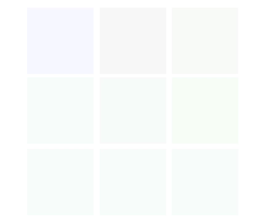

The monitor white should not be paper specific.  That's what the simulation profile is for. or Absolute colorimetric rendering  The environment is a whole different issue, and without getting into a dissertation on the subject I'll assume the OP understands those variables and leave them out of the scope of this question.
A monitor profile is there to describe a displays calibrated condition so it can display other media properly using ICC profiles.
To do that the white point must be native, and not casted.  Visual tweaking may be necessary to figure that out.  To check the accuracy of the monitors native white point you can use a set of printed squarea like the file attached on different white papers.
The reason for this is that the monitors controls and profiling tools cannot adjust pastel colors.  Those care controled by the accuracy of the monitor  If the paper used to print these patches is casted in the environment it's being viewed in then it will not produce a good match to an industry standard paper using the corresponding industry standard ICC profile.

You clearly haven't used NEC Spectraview or Eizo Colornavigator. Fine tuning the white point is a core function in this software, which communicates  directly with the 3D high bit LUT in the monitor.
Monitor profiles are relative colorimetric, absolute is not supported in the profile spec. That means white remaps to white, end of story. 255 255 255 in the document remaps to 255 255 255 in the monitor. If you want to accept the manufacturers preset white point, that's your choice. But that's all you get.
There's no such thing as an "uncast" white point. That's a misunderstanding. The white point has to be something, it can't be _nothing_.
Simulate paper color is a rough and inaccurate approximation. It kind of gets you "closer", but you have no way of knowing how close.

Hmm, I would expect a more respectful attitude from an ACP.   Let's keep this a helpful thread to the OP and less a personal attack, for someone you don't know.  Your comments although demeaning are quite inaccurate.  I have beta tested for NEC since 1995, installed the largest professional network of calibrated displays at press side serving US accounts, and have been elected to serve on the ICC stering Comittee for 11 years straignt and have just in the last 5 years steped down due to personal time constrainsts.  I also hold a US Patent in Color Technology.
Monitor profiles are written as relative colorimetric. But where Absolute colorimetric rendering is needed is the simulation profile, used to tell the monitor what it is displaying.  So for example ISO 15339-RPC5 or RPC5 both have different device gamuts and profile whitepoints.  Using these in Absolute colorimetric rendering intent is the most accurate way to color manage a system.   I have seen users that are unable to produce well formed profiles in their workflows and resort to the having different monitor white points for papers, but that is not the proper application of ICC technology.  The monitor profile is a device profile and if made properly and nothing else changes can and should be used in it's most accurate format.  One that describes the monitor white properly in the environment it's in.
Optically brightened papers can not be used for this process.  So checking for optical brightners in the printing paper for the test image I posted is the first step.  That can be done with a UV light source.  UV can not be adjusted for in the ICC profile process as it relates to the proper display of images on any monitor.
When this calibration portion is done properly on non-optically brightened papers or optically brightened papers viewed in an environment without a UV component to the lights used to view the prints.   So ISO 3664 Compliant Viewing may produce metamerisem failure due to the fact that the display can not match optically brightened reflectance.
You are correct in that setting up the monitor white point is dependent on the light in the viewing environment.  Where the OP must be careful is using supplied whitepoints for papers because your enviroment may be different.  The correct method is to accurately measure and profile the display, setting the whitepoint of that profile properly, then recognizing where this display system can fail to produce a metameric match.
